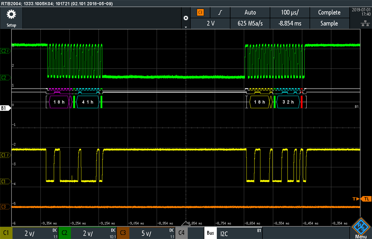

    thanks a lot for your explanation. We had a closer look at the read process. Now the read is terminated with a Read Timeout while polling for the ICRRDY Bit in the CSL I2C Read function.
    The following screenshot shows a good read. The AIC3254 codec has slave address 0x18. Register 0x41 is read and contains data 0x32.

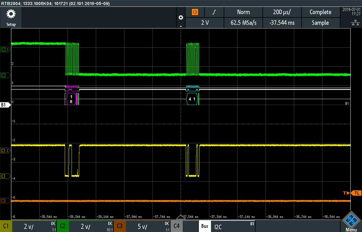

    The next screenshot shows an erroneous read. After the write of the register address, the I2C peripheral doesn't start the read sequence. This leads to a timeout error.

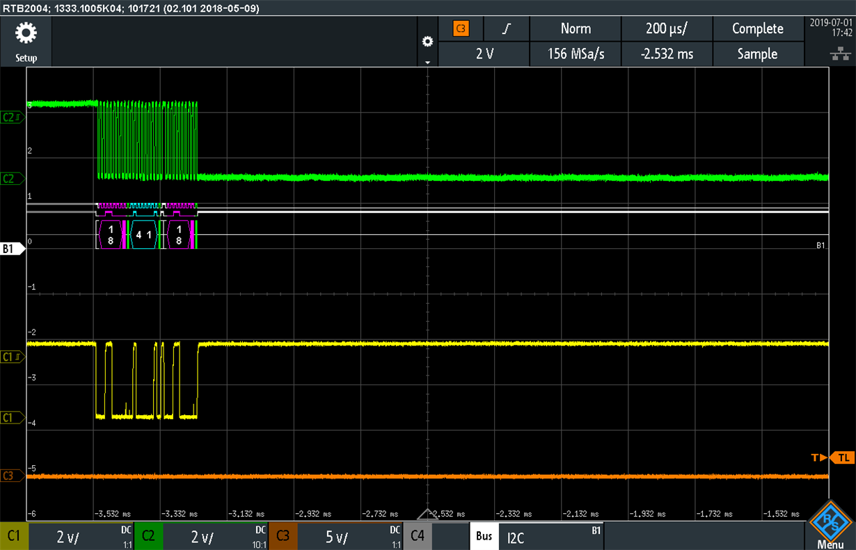

    The next screenshot also shows a timeout error. This time only the slave address is sent in the read sequence. The write bit is set instead of the read bit when the second slave address is sent.
    All the screenshot are initiated by the call of the i2c read function in the C55 CSL. This is really strange behaviour. It looks as if the i2c peripheral doesn't work correctly? Are there any known issues?

    we fixed the issue by changing the order of 2 lines in the I2C_Read() function in the CSL. Since we use DSP BIOS, the I2C task can be interrupted at any time by ISRs or other higher priority tasks. We saw that the order of initializing the write transfer in the I2C_read() function is different than in the I2C_Write() function. We removed the blue lines and inserted them at another position (red). Thus setting start or stop bit is done when all other initializations are finished.
    With this fix, we have no more I2C errors.
