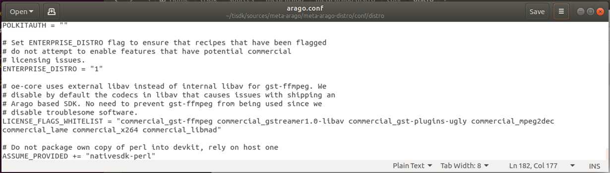

    The recipe for ugly plugin is available but by default the arago configuration prohibits the build of gst-ugly-plugins and some of its dependencies because of licensing limitations. Please, refer gstreamer1.0-plugins-ugly.inc and gstreamer1.0-plugins-ugly_$version.bb
    You could edit tisdk/sources/meta-arago/meta-arago-distro/conf/distro/arago.conf
    LICENSE_FLAGS_WHITELIST = "commercial_gst-ffmpeg \
                                                            commercial_gst-plugins-ugly \
                                                            commercial_mpeg2dec \
                                                            commercial_lame \
                                                            commercial_x264"
    MACHINE=<Machine> bitbake gstreamer1.0-plugins-ugly

    I made the follow changes to the arago.conf file. I have attached the file for you to view.

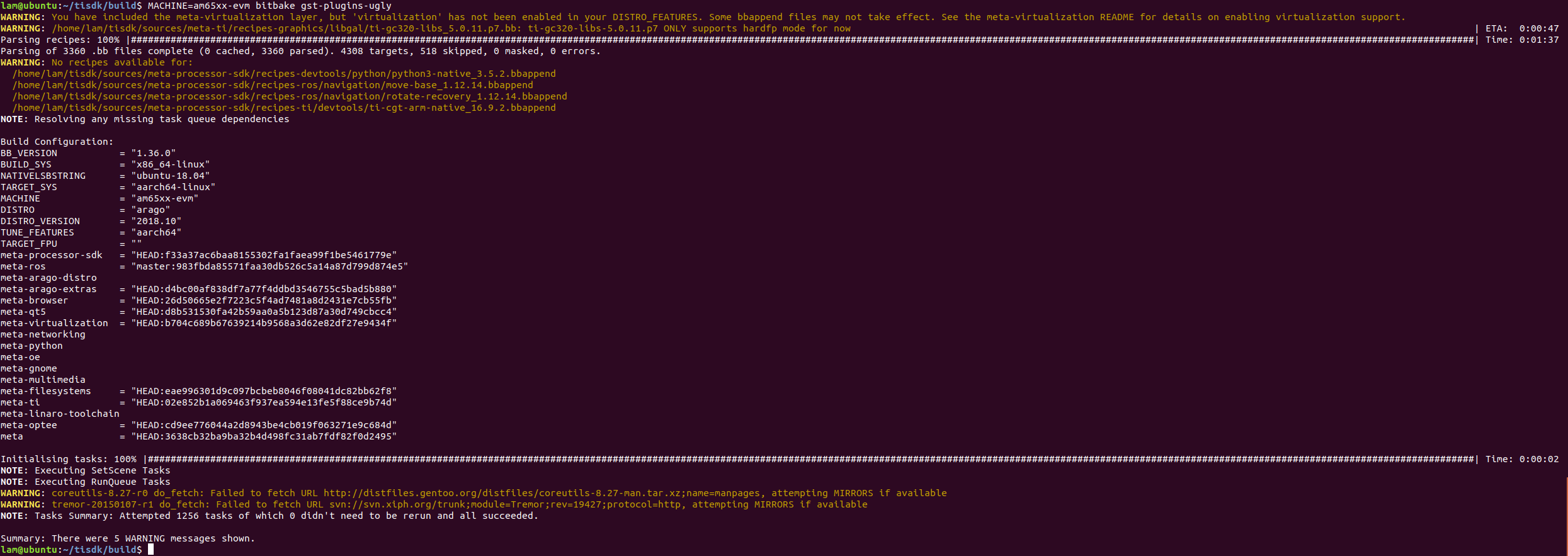

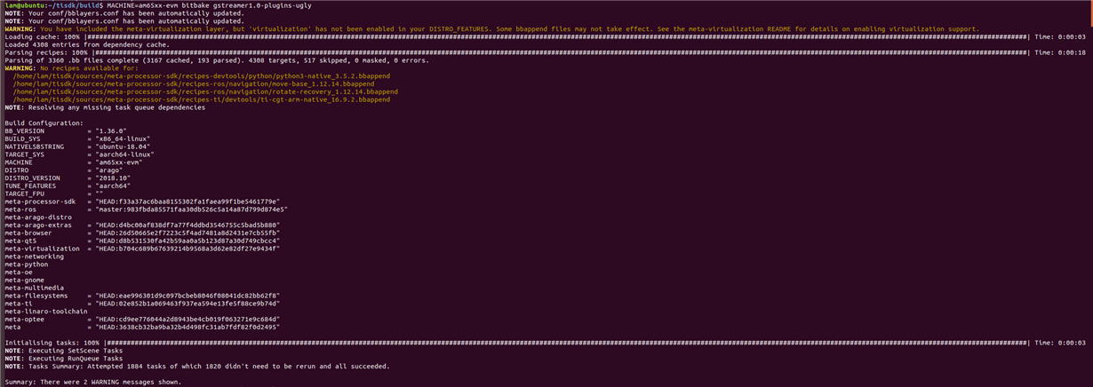

    I ran "MACHINE=am65xx-evm bitbake gst-plugins-ugly" and was not able to find libgstx264.so anywhere in the build directory
    then i tried running "MACHINE=am65xx-evm bitbake gstreamer1.0-plugins-ugly"* and still wasnt able to find libgstx264.so
    *note i had to update the whitelist in arago.conf from "commercial_gstreamer1.0-plugins-ugly" to "commercial_gst-plugins-ugly".

    did i miss something with the whitelist setup?

    i got it to work. I had to add x264 to the PACKAGECONFIG in gstreamer1.0-plugins-ugly.inc
    Yes, you must add it in gstreamer1.0-plugins-ugly.inc also.
