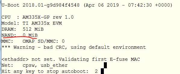

  • Kemal,
    I found a similar post your followed before: https://e2e.ti.com/support/processors/f/791/p/683793/2530829
    On my side, also can't recognize NAND on UBOOT:
    If it works on your side, please help to do a nand test:

  • Tony,
    I'm afraid your EVM may just be too old. I booted my rev 2.1 board and was able to see the NAND with no problems.

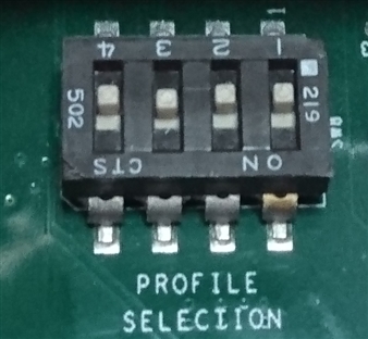

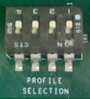

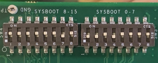

    I believe I had the board configured in it's default state, but to be most clear here is what I have:
    Profile Selection:
    Sysboot Pins:
    I hope this helps you.
