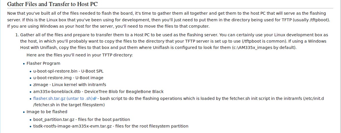

Now we are trying to flash eMMC using network booting without inserting SD Card. can you help me with how to do format eMMC through TFTP/NFS.
As of now I've followed the procedure given in the TI Website.
http://processors.wiki.ti.com/index.php/Sitara_Linux_Program_the_eMMC_on_Beaglebone_Black#Flash_the_Beaglebone_Black
we've copied all the files in the below image to /tftpboot.
We've also referred to the TRM section 26.1.9.4,

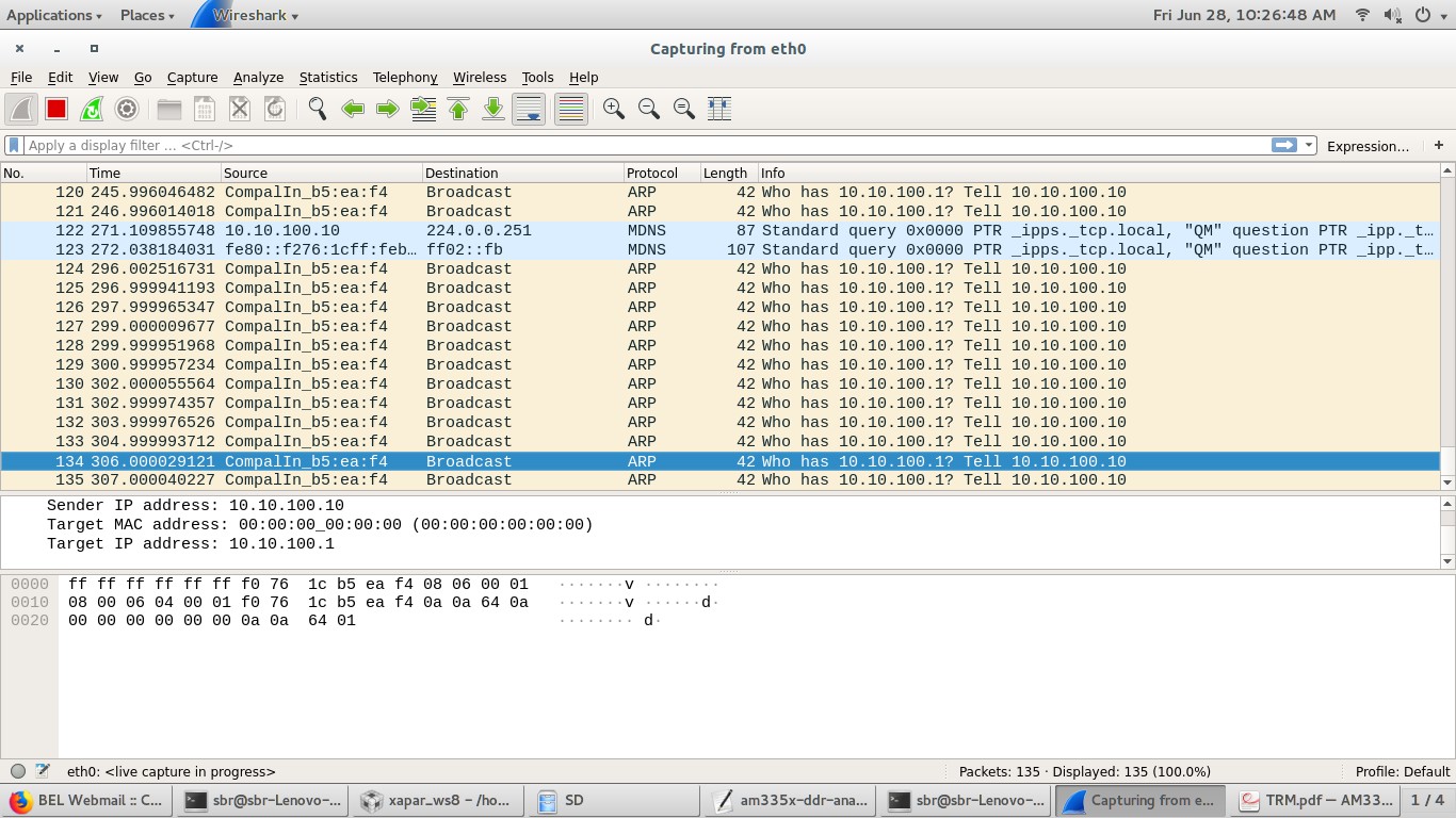

We just connected our board to host system through LAN and powered on the board. Following is the output on the terminal.
sbr@sbr-Lenovo-B50-80:~$ minicom -s
Welcome to minicom 2.7
OPTIONS: I18n
Compiled on Nov 15 2018, 20:20:04.
Port /dev/ttyUSB2, 08:57:41
Press CTRL-A Z for help on special keys
CCCCCCCCCCCCCCCCCCCCCCCCCCCCCCCCCCCCCCCCCCCCCCCCCCCCCCCCCCCCCCCCCCCCCCCCCCCCCCCCCCCCCCCCCCCCCCCCCCCCCCCCCCCCCCCCCCCCCCCCCCCCCCCCCCCCCCCCCCCCCCCCCCCCCC
CTRL-A Z for help | 115200 8N1 | NOR | Minicom 2.7 | VT102 | Offline | ttyUSB2
It is not getting any IP address and it seems that our board didn't send out any BOOTP request and didn't receive any response from the boot server.
Please check the attached screenshot of the frames captured in wireshark.
And my laptop has set IP to 10.10.100.10.
I want your help in this regard. Kindly help us.
