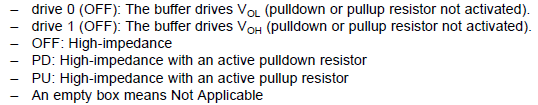

According to this Datasheet Table 4-2 Ball Characteristics , it has similar two parameters .
http://www.ti.com/lit/ds/sprs953f/sprs953f.pdf
My understanding is "PUPD State During HHV" =Ball Reset State" ,  "PUPD State After HHV = Ball Reset Rel. State".
Is this correct ? Also, what is HHV meaning ?
My understanding is "Ball Reset State == HHV=Hi meaning Pull up, Pull down = Both OFF.
"Ball Reset Rel. Sta = HHV=Lo  meaning  Pull up, Pull down = Both ON.
Kz777
    • My understanding is "PUPD State During HHV" =Ball Reset State" ,  "PUPD State After HHV = Ball Reset Rel. State".
    Correct
    • My understanding is "Ball Reset State == HHV=Hi meaning Pull up, Pull down = Both OFF. "Ball Reset Rel. Sta = HHV=Lo  meaning  Pull up, Pull down = Both ON
    I'm not understanding the question. The definitions are in the datasheet however.
