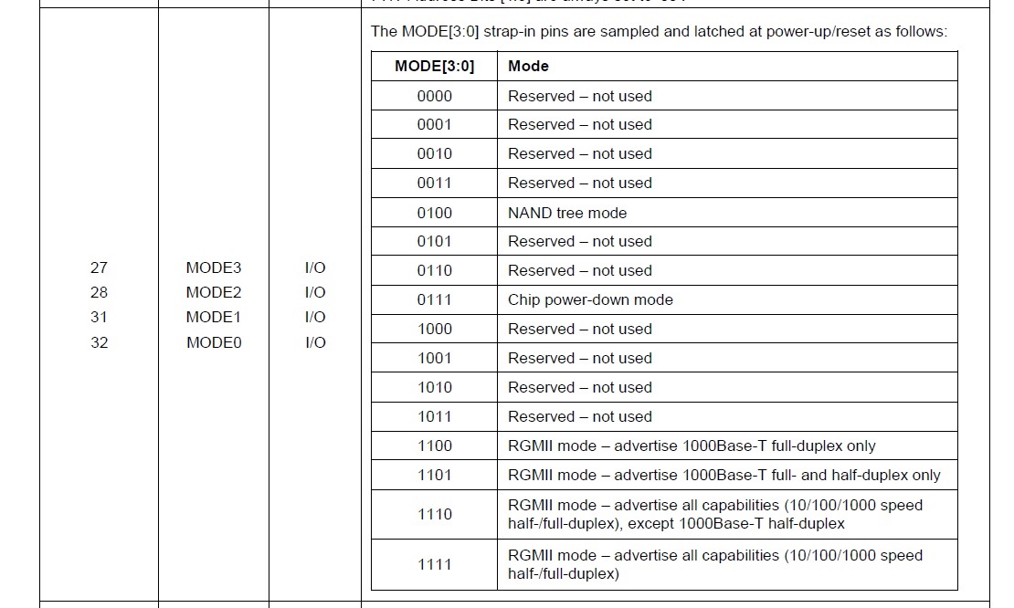

    CPSW in AM5718 EVM is connected via RGMII interface to Giga Bit PHY KSZ9031.
    In case of  KSZ9031 i need to operate it in 10/100 mode ie I will hardwire only 4 lines (Tx & Rx)
    1. here On wake up KSZ9031 is supposed to advertise 10/100 Mode . For this as i understand some changes are needed in uBOOT/Linux. Here I may need support to incorporate these features.

    Concerning the KSZ9031, the bit rate advertisement should be done as part of the HW strapping on the board. There should not have to be any software concerning the bit rate. The phy mode will need to set in the board DTS file.

    In case of KSZ9031RN
    1. For hardware bootstrap following schemes are available
    I could not find a explicit means of forcing PHY  set link to 10/100 mode or advertise 10/100 mode
    in their data sheet for 10/100 mode following procedure is recommended
  • In case of KSZ9031
    if uBoot needs to advertise 10/100 mode i guess above configuration should be performed by uBOOT on device wakeup.
