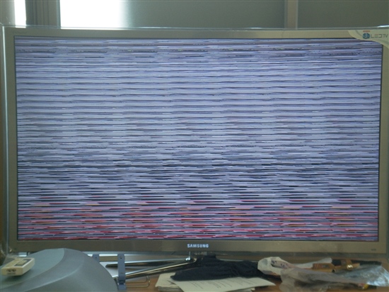

I'd like to output analog component  to my TV but i met a strange problem.
Platform : DM368 IPNC
Image Format : YUV420
Output Format : YPbPr(1920x1080i @60fps)
VENC and OSD Register Setting is like below and colorbar test is OK

But my output to TV is like below.
Maybe it related to the OSD Video window offset.
For test purpose, i changed the video window length like below
0x01c71c50 1920 --> 960
0x01c71c60 1920--> 960
At this time the output is ok but i can see only 960x1080 image.
The image is x2 zoom on horizontal direction.
 Is there anyone has same issue like me.

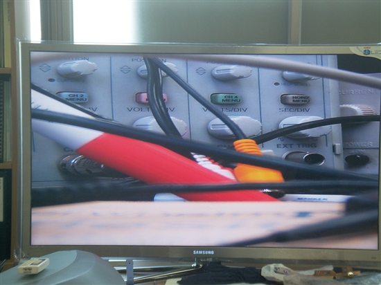

  • Dear Nagabhushana.
    I already did "capturing and displaying" but 'displaying' has problem like my explanation.
    But now the problem is fixed.
    The problem is the OSD_CLK0 and OSD_CLK1 in VENC register block.
    OSD_CLK0 : 0 and OSD_CLK1 = 1 is the correct setting for 1080i @60fps
    Thanks for helping.

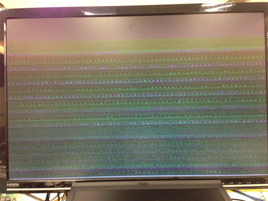

  • Dear Hennessy,
    I write a scrip to try to enable component output on 1080I60 mode. But I only see the garbage on LCD monitor. If I set VENC_VDPRO to enable color bar, the color bar is no problem. I also check OSD_CLK0/1 that you mention that the value is 0 and 1. What's your PLL2 setting? I can not get 74.25MHz(PLL2->PLLDIV5) when use ARM : 432MHz. The divider just gets the 72MHz for VENC clock. Can you please give me more hints on this portion? Thanks a lot.
    1080I60 Setting :

  • Dear Hennessy,
    Let me summarize my situation.
    I still can not bring up 1080I OSD setting when enable component output. Evenif I modify kernel/media/video/davinci/vpbe_osd.c.
    Can you please give me more lights on this portion?
    Thanks a lot.
