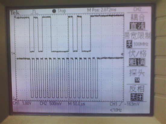

  • Thanks for your reply. I will explain it more clearly.
    I want to use one C6747 to boot another C6747. I set the host DSP's SPI as a MASTER, CLK is 250KHz. MSB(Most significant bit is shifted out first). SPI data word length is 16bits.
    According the PDF "sprabb1a-Using the TMS320C6747-45-43 Bootloader (Rev. A)" P19,  the original text is,
    "For the SPI and I2C slave modes, the bootloader operates the SPI/I2C peripheral in 16-bit mode, so that both start words are 16-bit (0x5853 & 0x5253). "
    And according The Note in P20 which says,
    so I should sent the data 0x5253 first, then 0x5853. I have observed my sending data through an oscilloscope. They're all right.
    But I didn't receive any data from the slave DSP.
    Do you have any suggestion?
    Kindly get back to me as soon as possible! Thanks!

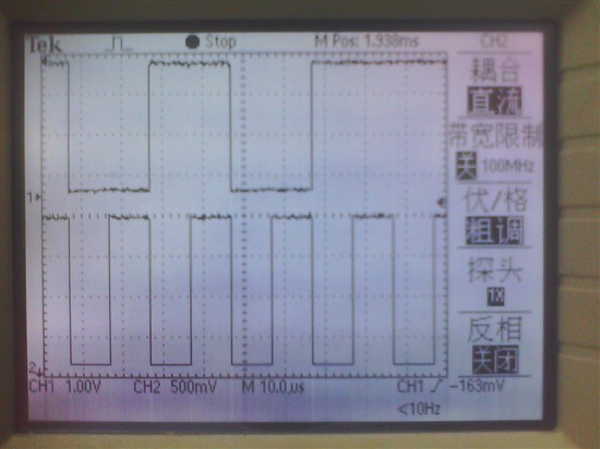

  • Thanks a lot! Your reply helps me understand the process of slave boot.
    Just as I said in the prior post, I set the SPI in Master mode, 16-bits, MSB. When I set my SPI CLOCK as 250KHz and send the 0x5853, there is no reply from the slave C6747.
    Then I set the CLOCK as 50KHz now. The specific sending process is as follows, The sending data is 0x5853. Why not the slave C6747 reponse? Can you give me any suggestion? Thanks very much!

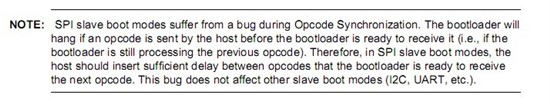

  • I have another doubt about the SPI boot.
    In the PDF "sprabb1a-Using the TMS320C6747-45-43 Bootloader (Rev. A)" P22, there is a Note,
    "Sufficient delay" is how long?  several hundred ns? or others?
    Please reply as quickly as possible!O(∩_∩)O~ Thanks!
  • Thanks a lot!  I know the reason. Because in C6747, SPI0 pins is also Boot pins, so when I connect the 2 SPI0 between 2 DSPs,  the 2 DSPs effect each other.
