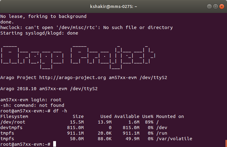

Hi!
Made a build on these links
https://www.digikey.com/eewiki/display/linuxonarm/BeagleBoard-X15
wrote to sd card (8 GB, 32 GB) and got a kernel panic (picture below)
Full text in file
Instead of the tiny flasher filesystem, I used arago-tiny-image.
Thanks!

  • Hello August,
    The U-Boot and kernel you use are not from the Processor SDK, so that the arago-tiny-image loading fails. Please, use <Processor SDK>/bin/create-sdcard.sh script while creating you SD card and flash all the component from the latest Processor SDK.
    Kemal
  • Can i use this post https://e2e.ti.com/support/processors/f/791/t/686920 to build the initramfs am57 **?
    Thanks!
  • Yes, but you can already find a tiny filesystem in <Processor SDK>/filesystem/ directory and use these similar steps to create an initramfs.
  • How determine what it works on ram fs?
    I used arago tiny sdk + dtb files and kernel image from build oembedded
  • Hello August,
    To boot your board trough ramfs or initramfs and stay in there you have two choices.
    Method 1. Use external ramdisk image.
    Install the latest Processor SDK and create SD card by using <Processor SDK>/bin/create-sdcard.sh script.
    cd <Processor SDK>/filesystem/
    mkdir ramdisk
    sudo mke2fs -vm0 /dev/ram 16384
    sudo mount -t ext4 /dev/ram ramdisk/
    sudo tar xvf arago-tiny-image-am57xx-evm.tar.xz -C ramdisk/
    sync
    sudo umount ramdisk
    sudo dd if=/dev/ram of=ramdisk.img bs=1k count=16384
    gzip -9 ramdisk.img
    mkimage -A arm -O linux -T ramdisk -d ./ramdisk.img.gz ramdisk.gz
    Copy the ramdisk.gz to SD card's second partition under /boot/ directory.
    sudo cp ramdisk.gz /media/<username>/rootfs/boot/
    Sync and safety remove the SD card from your host computer and boot your board with it. Stop the booting in U-Boot console and enter these commands.
    setenv devtype mmc
    setenv ramrootfstype ext4
    setenv ramroot '/dev/ram0 rw'
    setenv ramdiskfile ramdisk.gz
    setenv loadramdisk 'load ${devtype} ${bootpart} ${rdaddr} ${bootdir}/${ramdiskfile}'
    setenv ramargs 'setenv bootargs console=${console} ${optargs} root=${ramroot} rootfstype=${ramrootfstype}'
    setenv ramboot 'echo Booting from ramdisk ...; run ramargs; bootz ${loadaddr} ${rdaddr} ${fdtaddr}'
    setenv bootcmd 'run findfdt; run loadimage loadfdt loadramdisk ramboot'
    saveenv
    boot
    When the board booted, you will see this.
