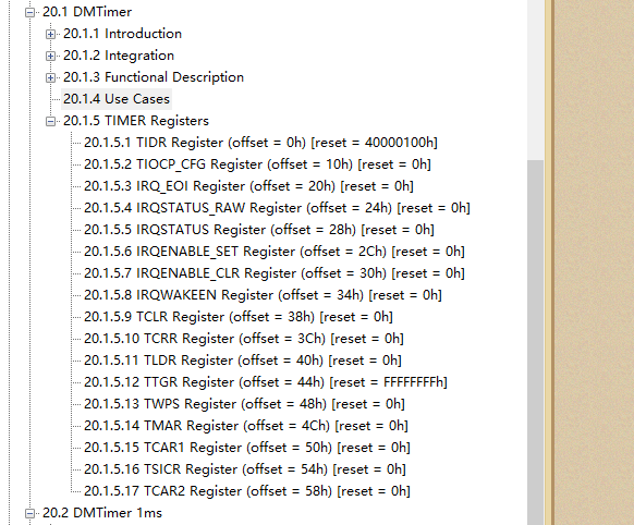

I want to know how the value of the am3x timer5 register address is obtained. According to what kind of formula, I want to operate the pwm of timer5. The operation is as follows, but I don't know how the address is obtained:
#configurations changed for Timer6
# Enable Timer4's clock in CM_PER
# This allows us to access it's control regs
#devmem2 0x44e00088 w 0x2
  • Hi user5355349,
    AM335x TIMER5 base address is 0x48046000, this is documented in AM335x TRM, Table 2-3. L4_PER Peripheral Memory Map
    CM_PER_TIMER5_CLKCTRL register address is 0x44E000EC (0x44E00000 + 0xEC, CM_PER + offset), see "Table 2-2. L4_WKUP Peripheral Memory Map" and "Table 8-30. CM_PER REGISTERS"
    Pavel
