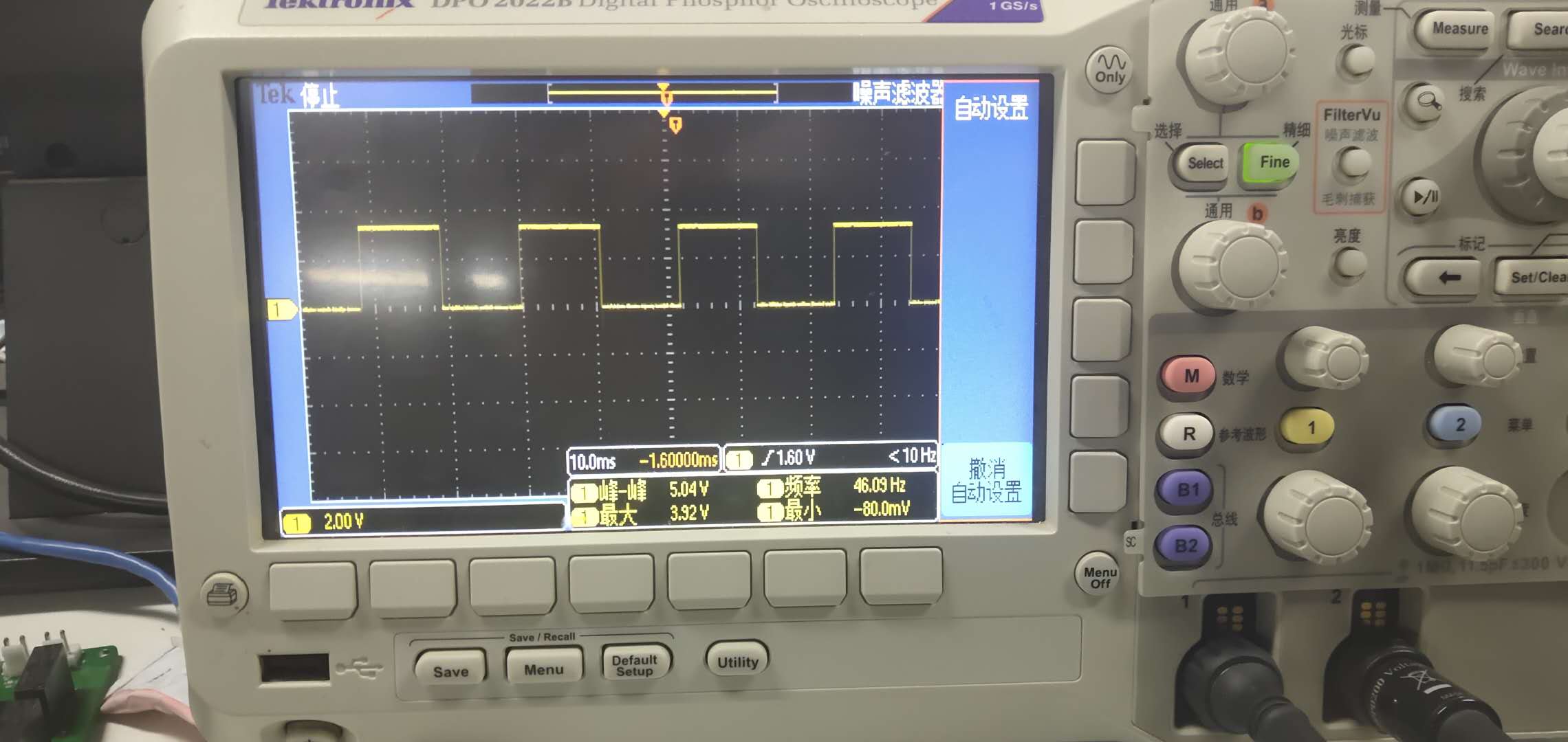

I need to configure timer5 as pwm function, modify the address according to other posts in the forum, run the program can reach a pwm waveform, but need to modify the period and duty cycle, try to modify the failure.
Changed to 2500us cycle, modified three places, but the test cycle is wrong
TLDR register value ffffffae
 PRE 0 TCLR Register 48
 Clock input of 32 kHz CLKSEL_TIMER5_CLK 0x02

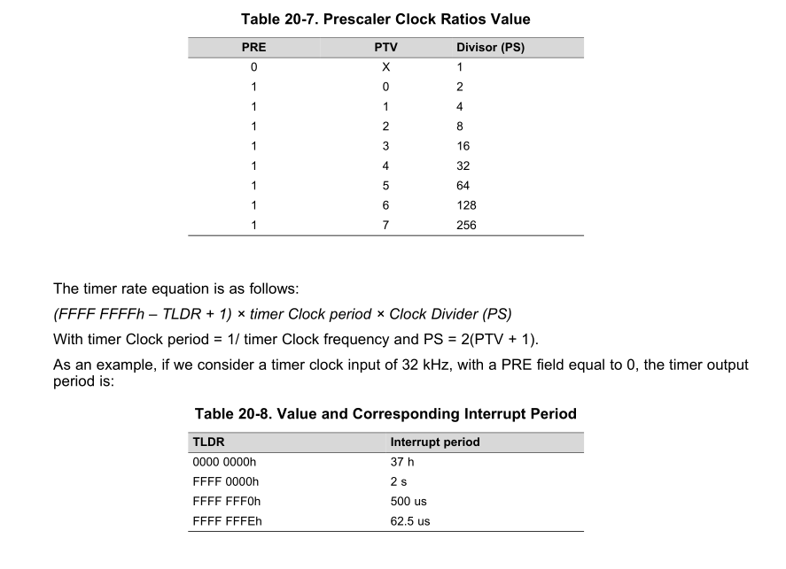

Modify the case in a manual The register TLDR register value is changed to FFFF FFF0, the clock is originally selected 32kHZ, PRE=0, the period should be 500us, but the actual waveform period is not.
Below is the code is the implementation of the test example

I want you to help me see where there is a problem?

In addition, I want to know how to calculate the duty cycle configuration.?
    From what I understand you need to set 500us (2KHz) period on timer5 out pin, is that correct?
    Which timer5 pin exactly you are using? Have you verified the pinmux register is correct? You want 2KHz on that pin, but what frequency your observe there?
