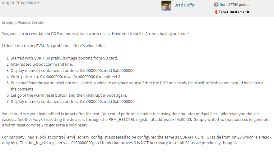

I follow this steps except not use reset button, but write 1 to PRM_RSTCTRL to do the warm reset.
But after the reset, interrupt the uboot, still found that the DDR data lost.
I don't know how to make sure that DDR is in the self-refresh before the reset, when using PRM_RSTCTRL to do the warm reset.
