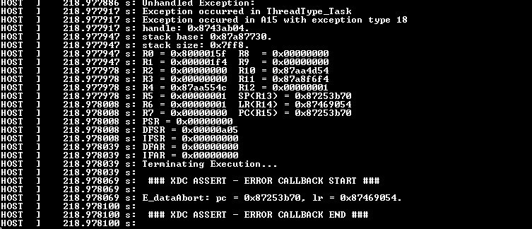

In mcan Rx ISR I am posting an event, the event is causing exception.
 Event_post(mcanRxEvent,UTILS_MCAN_RX_EVENT);
It’s crashing from “Void Event_post(Event_Object *event, UInt eventId)” function when its checking for matching eventIds in Queue.
               /* examine pendElem on pendQ */
    elem = (Event_PendElem *)Queue_head(pendQ);
    /* check for match, consume matching eventIds if so. */
    elem->matchingEvents = Event_checkEvents(event, elem->andMask, elem->orMask);

    Above can happen due to 2 reasons:
    1. 'event' is not properly getting created in the system.
    2. 'event' is getting corrupted after creation  and before ISR.
    Check the contents of 'event' after creation and in the ISR before posting on it.
    Can you put break-point just before failure point and see if 'event' is proper before posting on it? If not and it is getting corrupted, then you can put data watch-point on 'event' and see where exactly it is getting updated/corrupted.
