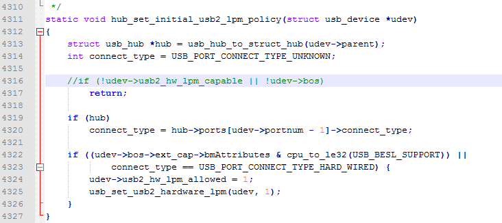

AM4378: 4.14.79-rt47-LCKJ-PLC-4.0.0 #13 PREEMPT RT Tue Jul 9 12:47:20 CST 2019 armv7l GNU/Linux
[ 51.352186] usb 1-1: USB disconnect, device number 2
[ 55.156232] usb 1-1: new high-speed USB device number 3 using xhci-hcd
[ 55.343812] usb 1-1: New USB device found, idVendor=058f, idProduct=6387
[ 55.351182] usb 1-1: New USB device strings: Mfr=1, Product=2, SerialNumber=3
[ 55.358891] usb 1-1: Product: DataTraveler 2.0
[ 55.363593] usb 1-1: Manufacturer: Kingston
[ 55.368154] usb 1-1: SerialNumber: F6EFF7AA
[ 55.375598] usb-storage 1-1:1.0: USB Mass Storage device detected
[ 55.388176] scsi host0: usb-storage 1-1:1.0
[ 56.408233] scsi 0:0:0:0: Direct-Access Kingston DataTraveler 2.0 8.07 PQ: 0 ANSI: 4
[ 56.410698] sd 0:0:0:0: [sda] Sector size 0 reported, assuming 512.
[ 56.410718] sd 0:0:0:0: [sda] 1 512-byte logical blocks: (512 B/512 B)
[ 56.410723] sd 0:0:0:0: [sda] 0-byte physical blocks
[ 56.411115] sd 0:0:0:0: [sda] Write Protect is off
[ 56.411524] sd 0:0:0:0: [sda] Asking for cache data failed
[ 56.411530] sd 0:0:0:0: [sda] Assuming drive cache: write through
[ 56.414049] sd 0:0:0:0: [sda] Sector size 0 reported, assuming 512.
[ 56.486754] sd 0:0:0:0: [sda] tag#0 UNKNOWN(0x2003) Result: hostbyte=0x00 driverbyte=0x08
[ 56.486765] sd 0:0:0:0: [sda] tag#0 Sense Key : 0x3 [current]
[ 56.486770] sd 0:0:0:0: [sda] tag#0 ASC=0x14 ASCQ=0x0
[ 56.486781] sd 0:0:0:0: [sda] tag#0 CDB: opcode=0x28 28 00 00 00 00 00 00 00 01 00
[ 56.486788] print_req_error: critical medium error, dev sda, sector 0
[ 56.574430] Buffer I/O error on dev sda, logical block 0, async page read
[ 56.656692] sd 0:0:0:0: [sda] tag#0 UNKNOWN(0x2003) Result: hostbyte=0x00 driverbyte=0x08
[ 56.656702] sd 0:0:0:0: [sda] tag#0 Sense Key : 0x3 [current]
[ 56.656708] sd 0:0:0:0: [sda] tag#0 ASC=0x14 ASCQ=0x0
[ 56.656717] sd 0:0:0:0: [sda] tag#0 CDB: opcode=0x28 28 00 00 00 00 00 00 00 01 00
[ 56.656724] print_req_error: critical medium error, dev sda, sector 0
[ 56.692277] Buffer I/O error on dev sda, logical block 0, async page read
[ 56.699590] sda: unable to read partition table
[ 56.709629] sd 0:0:0:0: [sda] Sector size 0 reported, assuming 512.
[ 56.710352] sd 0:0:0:0: [sda] Attached SCSI removable disk
[ 56.836745] sd 0:0:0:0: [sda] tag#0 UNKNOWN(0x2003) Result: hostbyte=0x00 driverbyte=0x08
[ 56.836756] sd 0:0:0:0: [sda] tag#0 Sense Key : 0x3 [current]
[ 56.836761] sd 0:0:0:0: [sda] tag#0 ASC=0x14 ASCQ=0x0
[ 56.836771] sd 0:0:0:0: [sda] tag#0 CDB: opcode=0x28 28 00 00 00 00 00 00 00 01 00
[ 56.836779] print_req_error: critical medium error, dev sda, sector 0
[ 56.884952] FAT-fs (sda): unable to read boot sector
[ 60.405601] usb 1-1: USB disconnect, device number 3
