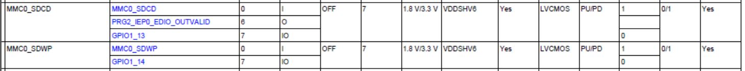

    1.  The voltage supply change will be reflected in future silicon revisions.  We will be publishing an errata advisory for AM65x SR1.0 highlighting that the LVCMOS IOs associated with device pins MMC0_SDCD (A23) and MMC0_SDWP (B23) receive power from VDDSHV6 and device pins MMC1_SDCD (B24) and MMC1_SDWP (C24) receive power from VDDSHV7 rather than VDDS_OSC1 on AM65x SR1.0.
    In revision F datasheet, the voltage supply for MMC0_SDCD (A23) and MMC0_SDWP (B23) were powered from VDDSH6. However in the updated datasheet, it is changed to VOSC1. Attached image for details. Could you please clarify if VDDSH6 is the correct power supply associated it these balls.
    REVF _Datasheet
    REVH _Datasheet

  • Hi Sushruta,
    Yes, VDDSHV6 is the correct power supply for AM65x SR1.0.
