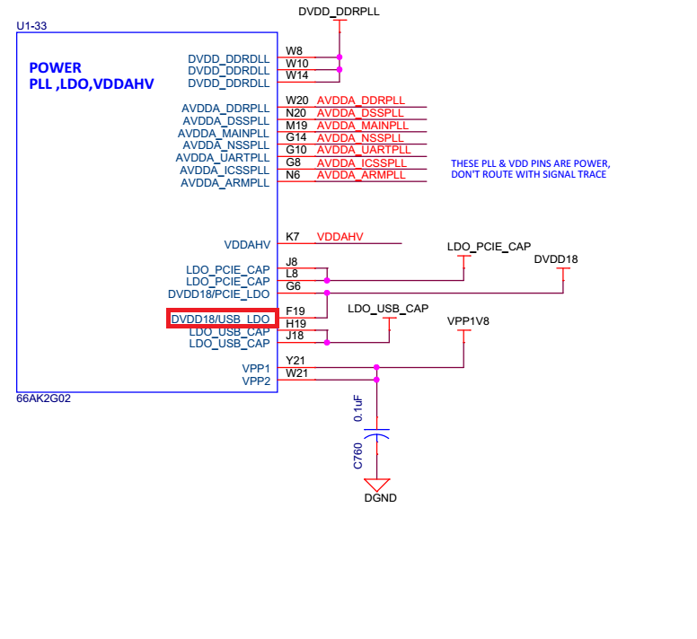

    In addition, my customer has a question about F19 pin. This is DVDD18, but the EVM schematic implies this is regarded as USB_LDO. Please take a look at the following. This is a snapshot from EVM schematic.
    As per datasheet, this pin is just a DVDD18, but my customer is wondering if they might need some special handing for this pin to improve clock quality.

    4. and, special handing needed or not for DVDD18/USB_LDO (F19)
    - I checked with the design team concerning this. Since the 1.8V is used as a source voltage for the LDO, the expectation is that the output of the LDO will not be effected by the specified amount of noise on the 1.8V rail. That is why the pin name was grouped with the other DVDD1V8 power pins.
