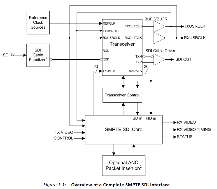

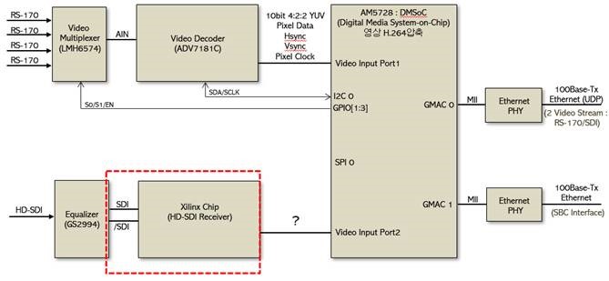

Customer wants to use Camera module which output is 5-bit LVDS from LMH0341 for AM5728 Camera input as below block diagram.
Can AM5728 get 5-bit LVDS from LMH0341?
Can customer use above block diagram?
