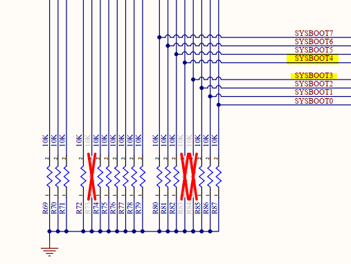

I need to implement a bootloader on my AM4377-based custom board. It has SDRAM slightly different from IDK or GPEVM board, it is DDR3L MT41K256M16TW-107 AAT.
The SDRAM timings are different from IDK/GPEVM boards, I use specific gel files and my projects run fine on this board when loaded from CCS. I can prepare the bootable MicroSD card for IDK board and it works like a charm (I put my MLO/app files). But when I take "ti\pdk_am437x_1_0_14\packages\ti\starterware\bootloader" as example, adjust timings, rebuild with this command:
gmake bootloader BUILDCFG=boot PLATFORM=am43xx-evm BOOTMODE=mmcsd
and put the binary with TI header to the SD card:
bootloader_boot_mmcsd_a9host_debug_ti.bin -> MLO
Then nothing is working! My board just keeps complete silent about any attempts to boot from SD card. I don't see any messages! Neither on console nor on serial port.
The SYSBOOT lines on my custom board to select the boot devices are set to the EXACT same values as for IDK_AM437x board.
As shown below, on IDK_AM437x board only signals SYSBOOT[3,4,14] are connected to 3.3VDC, others are grounded.
On my custom board they are routed exactly same way:
I check the CTRL_STS register:
IDK_AM437x board, CTRL_STS (0x44e10040)  = 00400318
Custom board, CTRL_STS (0x44e10040)          = 00400308
CTRL_STS register on my board is different (1 bit is different), but I tried to set it through CCS to the same value as IDK board and it doesn't change anything.

  • Oleg,
    The bootloader provided in the Processor SDK RTOS is unlikely to work as is on the custom platform unless your design implements the HW exactly as the evaluation HW.  There are two articles in the software developers guide that will be useful for you to look at as you port the Processor SDK RTOS package to your custom board
    Custom board porting:
    http://software-dl.ti.com/processor-sdk-rtos/esd/docs/latest/rtos/index_board.html#custom-board-addition
    It appears that you have completed step one and have the code loading and running over CCS so please confirm that ROM is loading the secondary bootloader and the UART where debug logs are being setup is setup correctly from the secondary bootloader from Processor SDK. Please review the section that talks about board ID detect mechanism and confirm that your board uses personality EEPROM and boardID structure similar to IDK platform.

  • Thanks Rahul,
    I was able to convince RBL to load my custom SBL (there were HW error on my board in wiring SYSBOOT0 lines, but I changed CTRL_STS register manually and RBL is loading my SBL from the MMCSD).
