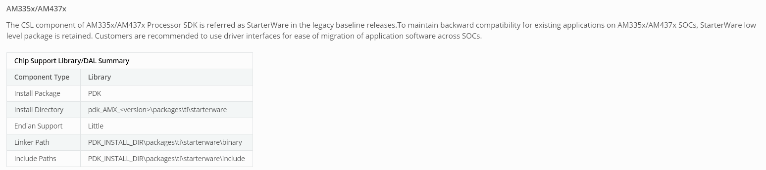

  • Chandana,
    Other than the code, we have no understanding of your code here. Can you please indicate if this is bare-metal or RTOS example. Is this a custom board or a TI evaluation platform. What data are you passing to UART from the host side to trigger the receive interrupt?
    Based on my understanding of your code, you are using legacy starterware.  Can you indicate why you are not using the UART driver that we provide here:
    pdk_am335x_1_0_13\packages\ti\drv\uart
    If you are looking for bare-metal UART Examples for AM335x, you can refer to diagnostic package under board folder. Please migrate to using UART LLD driver as the legacy starterware package is provided for existing industrial customer to migrate their code base to Processor SDK. We are only supporting the bootloader and the board and flash package from starterware in Processor SDK.
    Rahul

  • Chandana,
    We have indicated in several earlier posts that Starterware software is obsolete and is no longer supported for new development.  The cut down version of starterware package in Processor SDK RTOS is only for legacy industrial customer to migrate their code base and to support the secondary bootloader functionality.
    You can clearly check this indicated in the Processor SDK RTOS FAQ as indicated in the screenshot below:
    This is also indicated in the Processor SDK RTOS CSL documentation:
    Please migrate to using UART driver in the PDK package for support from E2E forums as the code base in question here is not supported since we started supporting AM335x platform with Processor SDK RTOS releases.
    Rahul
