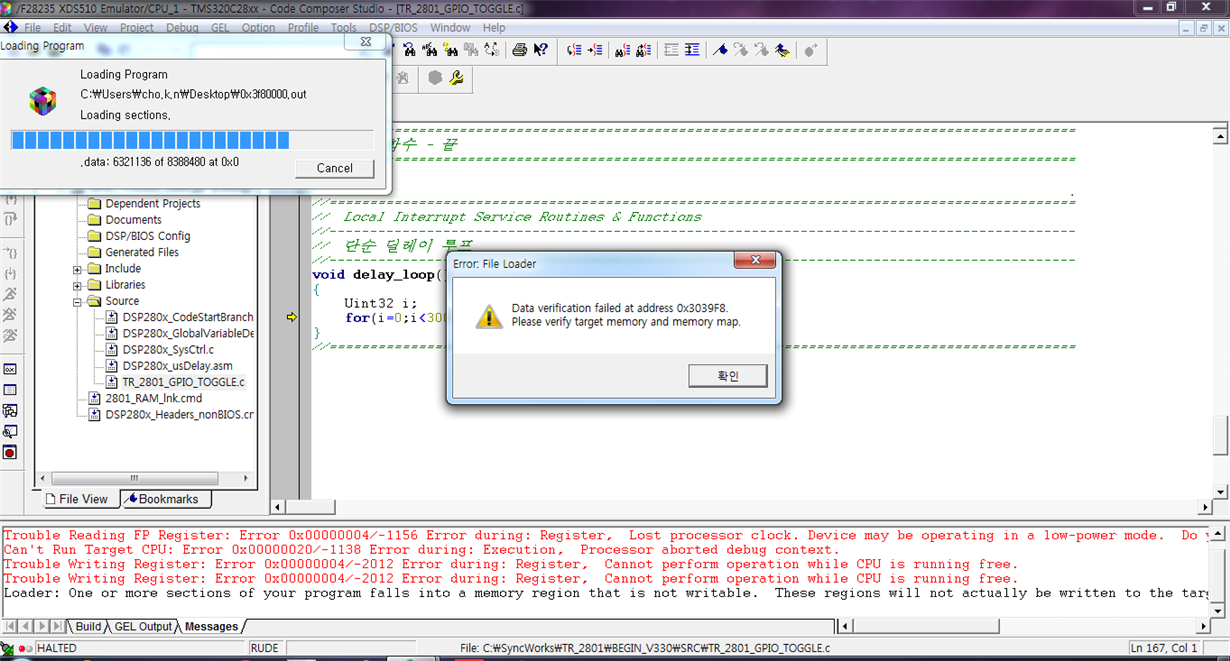

  • Thanks for the answer.
    I saved the memory area from the file 'File-> Data-> Save' to the PC as a COFF format (* .out) file.
    The size of the * .out file created is 8mb.
    I loaded the generated file.
    An error has occurred
    Did I set the address incorrectly when I save ?
    So I changed the address value.
    If you change the memory address from 0x000000 to 0x100000 ----> it does not work.
    If you change the memory address from 0x300000 to 0x3ffffff     -----> An error occurs.
    How can I save it?
    This is an error message.
    Looks like you tried to dump ALL memory from 0x0 to 0x3fffc0? Is that what you wanted?
    Anyway, the error you are getting when you try to load the file is a data verification error. That error is documented in detail in the below link:
    http://dev.ti.com/tirex/explore/node?node=APy2XbLelxyqBB2Yz0WR.w__FUz-xrs__LATEST

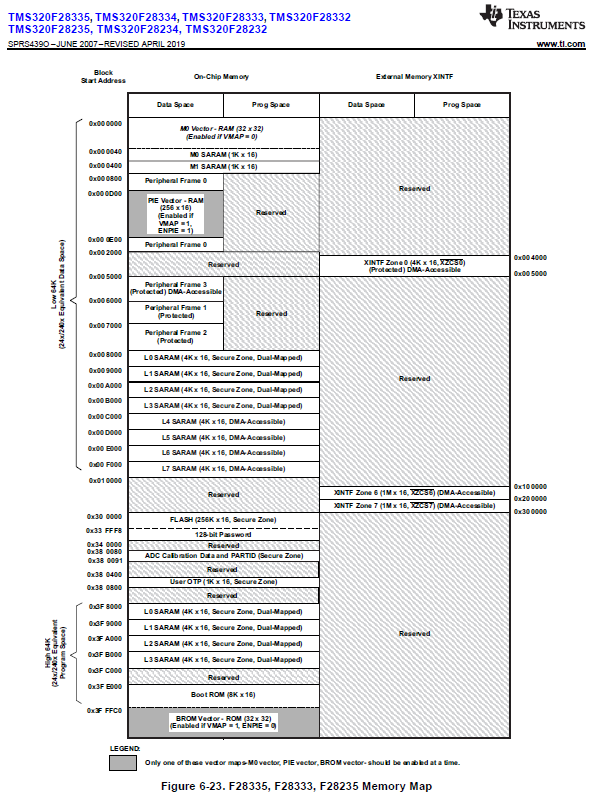

    In your case, I'm guessing the 0x3039F8 is FLASH. You will not be able to use the file loader to write to FLASH. You need to use the flash utility to program to flash.

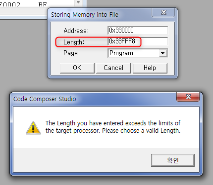

    CCS 3.3 파일 -> 데이터 -> 저장
    주소 및 길이를 작성하는 방법을 알고 싶습니다.
    플래시를 저장하고 싶다.
    1. 주소 : 0x000000, 길이 : 0x3FFFC0
    2. 주소 : 0x300000, 길이 : 0x33FFF8
    않은 경우이를 오는가
    지정하는 방법을 알고 싶습니다.

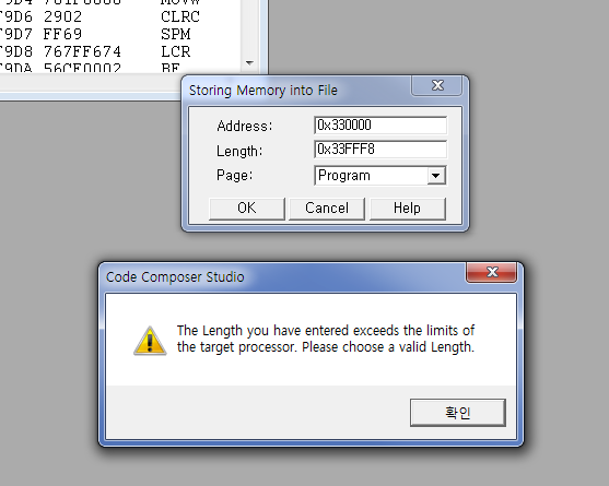

  • "Length" means number of bytes to save.
    "Address" is the start address of where you want to start saving memory contents
    In your screenshot you selected:
    Address: 0x330000
    Length: 0x33FFF8
    You are telling the debugger to save all memory from 0x330000 - 0x66FFF8 (which is an invalid range and why you get the erro).
    I assuming this is NOT what you want.
    If you want to tell the debugger to save all memory from 0x330000 - 0x33FFF8, then use:
    Address: 0x330000
    Length: 0xFFF8
