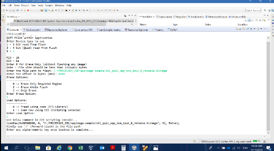

  • Prakash,
    Can you share a screenshot where you have tried loading via scripting console.
    Rishabh
    Please find the attached screenshot below,
