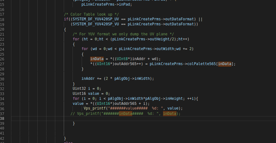

Hi TI team,
I have successfully deployed my trained model on tda2. Now I want to apply image processing further which could help me generating the required output. I have two questions about it and detailed answers will be highly appreciated.
1. How can I see the pixel values of each classes at the tidl_postproclink, I added some part of the code but I can't understand the output it is generating. What I need is the pixel value of each classes of my segmented objects. So far, I have only two objects. Here is the picture below of my code:
2. Adding this for loop and print function also disturbs my output on the display and make it completely black. How to deal with issue also, do I need to allocate any memory before doing any such thing, if yes, can you give me some hint on it?
Kindly respond me asap. Thank you.

    Printing such a large array in short time is not possible, so you are getting improper display.
    You can add a dup link after tidlpostproc and add a null link on IPU1_0 core to dump that output and check.
    Anuj

    If i have clearly understand your usecase then you want to check the output of tidlpostproc link.
    In order to do that you have to dump that data in sd card as printing those data is not possible.
    you can dump that data using null and dup link.
    replace below line from usecase txt file
    Alg_tidlpostproc (A15) -> Merge (A15)
    and add below lines
    Alg_tidlpostproc (A15) -> dup_1 (A15)
    dup_1 (A15) -> Null.
    dup_1 (A15) -> Merge (A15)
    And set dup and null link params correctly.
    For these params you can take reference from other usecase where these links has been used.
    Anuj
