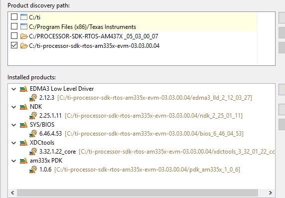

I import project in pdk\packages\MyExampleProjects into ccs and build these project. But failed and below is the error message.
There are no i2c_arm_icev2am335x_pa8fg.h and i2c_arm_icev2am335x_pa8fg.c in MyExampleProjects\I2C_Example_icev2AM335x_armExampleProject\Debug\configPkg\package\cfg
  • Hi Nancy,
    You should check if AM335x PDK component was successfully installed in your CCS. Open CCS, then select “Window" -> "Preferences” -> "Code Composer Studio" -> "Products". Make sure you have "am335x PDK" into the "Installed products" list. Refer to the below user guide for details:

  • This is my product folder.
    What is the function of package/cfg/i2c_arm_icev2am335x_pa8fg.xdl ? I did not find this file. The error message are related to package/cfg/i2c_arm_icev2am335x_pa8fg.xdl

  • Nancy,
    I am working on Linux, and I have this file in below folder:
    /home/[user]/ti/pdk_am335x_1_0_14/packages/MyExampleProjects/I2C_Example_icev2AM335x_armExampleProject/Debug/configPkg/package/cfg/i2c_arm_icev2am335x_pa8fg.xdl
    I have RTOS folder and PDK folder in /home/[user]/ti:
    /home/[user]/ti/processor_sdk_rtos_am335x_5_03_00_07/
    While I see your PDK folder is inside your RTOS folder:
    C:/ti-processor-sdk-rtos-am335x-evm-03.03.00.04/pdk_am335x_1_0_6
    This does NOT looks correct to me. Please refer to the below user guide. It explains that you need to install RTOS in C:/ti for Windows and /home/[user]/ti for Linux
    I would suggest you to make fresh install of RTOS package components with following the below user guide:
    Pavel

  • Nancy,
    I can not reproduce your problem on my side. But I am doing the things in different procedure. That is why I recommend you to try this way. Install RTOS components in C:\ti. The purpose is to have:
    C:/ti/processor_sdk_rtos_[soc]_[version]
    C:/ti/pdk_[soc]_[version]
    C:/ti/xdc_[xdc_version]
    C:\ti\ccsvx
    etc
    Pavel
