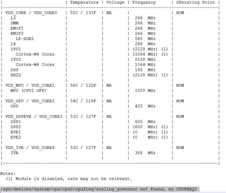

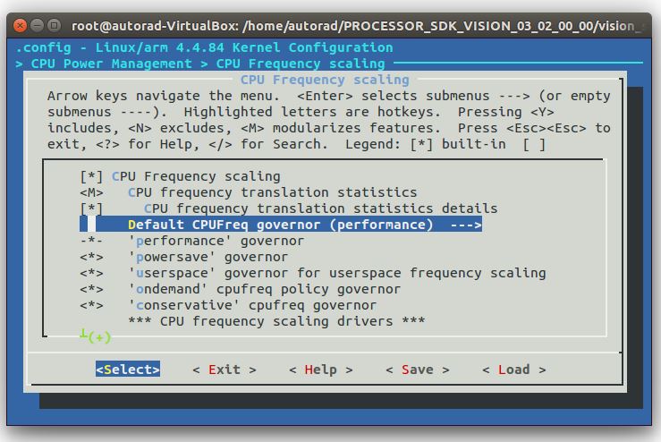

Hi
I try to use make kernel_menuconfig to set governors is Performance.
But I use omapconf show opp to check freqency is still 1000HZ.
System also show can not find scaling_governor file message.
Did I less some procedure or DRA72x  can not use kernel_menuconfig set A15  freqency?
thanks
Yumei
  • Hi Yumei Hang,
    Selecting cpufreq governor from menuconfig should work.
    Could you share the full Kernel boot log and your kernel ".config" file (after you have built Kernel)?
    Vishal

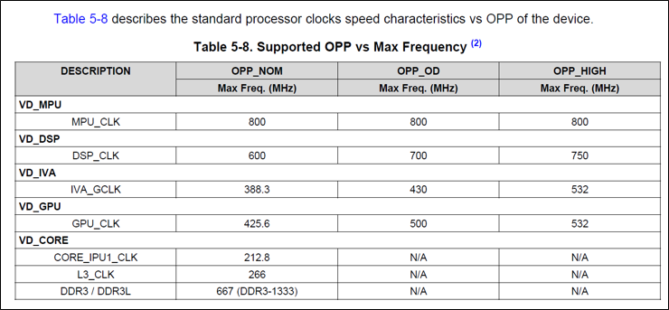

  • Hi Vishal
    There are my .config file and procedure message when I run sd card.
    Is MPU max freqency 800?
    Because I see tda2ex file table is show 800,but mpu default freqency is 1000.
    thanks
    Yumei

  • Hi Vishal
    I use u-boot change freqency successfully.
    Can I chane OPP_NOW to OPP_OD or OPP_HIGH?
    Has default OPP_NOW 1000 MHz to belong overclocking condition?
    So I use Kernel change freqency unsuccessfully Because DRA72x is just one OPP?
    thanks
    Yumei
  • Hi Yumei
    Recommend you to remain with OPP_NOM for TDA2Ex and 800 MHz as per the datasheet to avoid having higher leakage power than necessary.
    http://www.ti.com/document-viewer/TDA2E/datasheet/voltage-and-core-clock-specifications-voltage-core-clock-specs#SPRT637-1342
    The 1000 MHz is for DRA72x device which is very similar to TDA2ex but supports different frequencies/OPPs: Kindly refer: http://www.ti.com/document-viewer/DRA726/datasheet/voltage-and-core-clock-specifications-voltage-core-clock-specs#SPRT637-1342
    Thanks and Regards,
    Piyali
