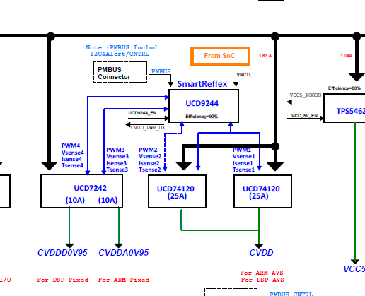

I have a customer who is designing 66AK2H06 custom board.
He is using EVM2K as a reference (see below power block).
Q1) There are two UCD74120 ICs used for CVDD (ARM and DSP AVS power supplies).
I guess this is only because one UCD74120 is not enough to supply CVDD.
Correct?
Q2) UCD7242 has two channels and each one is used for CVDDD0V95(= CVDD1 for DSP) and CVDDA0V95(=CVDD1T for ARM), respectively.
I understood each channel can supply up to 10A based on UCD7242 datasheet.
http://www.ti.com/product/UCD7242
Why two channels are needed to provide CVDD1 and CVDD1T?
Using only one channel for both power rails may cause an issue?
