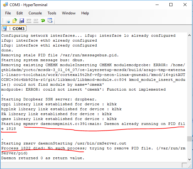

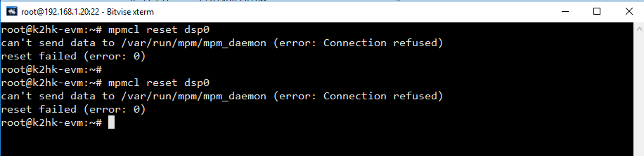

Hi, everybody
I run dsp code on dsp0 on EVMK2H,using command line to reset ,load and run like below,
mpmcl reset dsp0
mpmcl load dsp0  test.out
mpmcl run dsp0
It is OK  in most cases. but sometime it reset fail like below.
But when I turn off power of EVMK2H, and turn on again .It run OK and  reset success.
I don't know why reset failed sometime.Do someone know about that?Or have any clue or tips to debug ?
