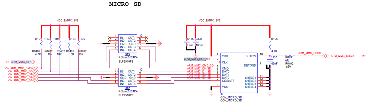

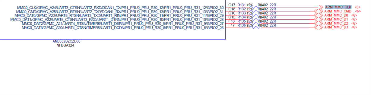

We designed a board with the am3352.
We are using the sdk AM335xSDK  08_00_00_00, linux kernel version:3.14.26
Problem:
sd card failed to initialize after soft reboot, and sd card succeed to initialize after borad power off /power on.
could you please help us?
our hardware design ( sd part)
our dts (mmc part)

  • our hardware design ( sd part)

  • Hello user4865815,
    Can you switch to the latest Processor SDK, comment out the disable-wp;, uncomment vmmc-supply and capture these diagrams?
    Kemal
  • Hi Kemal,
    I uncomment vmmc-supply, this issue have been solved.
    Thanks a lot for your suggestion.
