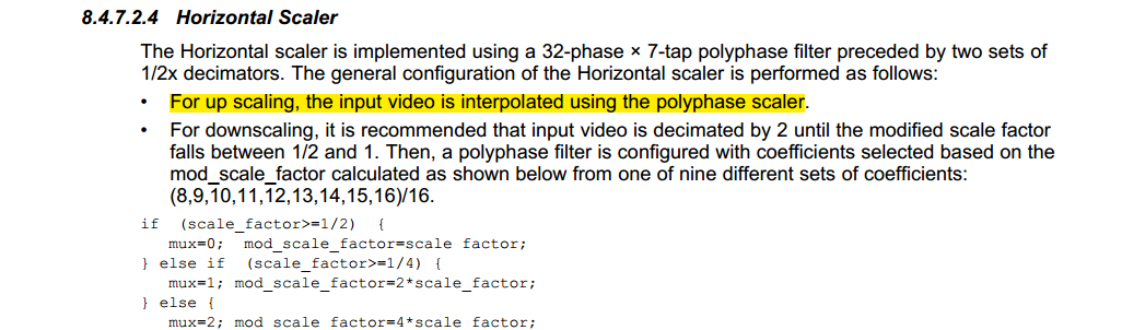

I use a camera connect to TDA3x
I want to use the capture to upsample  the in steam. But is failed
I set the capture_out_width and capture_out_height is 2x than the capture_in_width and capture_in_height
But the display image is wrong like that
Than I set the capture_out_width and capture_out_height is 1/2x than the capture_in_width and capture_in_height
The image is ok.
I read the code ,than same define like this
Is than mean. The vip scaler  do not support upsample ?????
