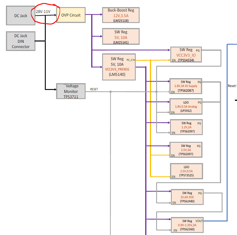

Is there a software way to read the voltage of DC Jack in Linux?
I read the output voltage of the TPS62363 via I2C interface, but this is not what I need for my project.
Best regards!
  • Hi Silviu,
    There is not a software method for reading that voltage. The pre-regulator power supplies are designed to accept any voltage between 11V and 28V as a source supply voltage. We do not need to know what that voltage is as long as it is within the limits specified by the over-voltage circuit.  Once the supply voltage is present, the rest of the supplies will be sequenced by their power good signals.
