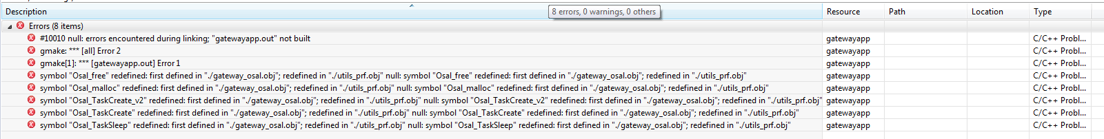

I am attempting build the CAN-ETH gateway example from CCS by creating a project and importing the source and build files. The project will be tested on the TMDX654IDKEVM, and the purpose is to get it running from CCS to make development of this simpler. At the moment I am quite stuck and was hoping someone could provide some assistance to make this work.
The following 2 error codes I am finding trouble resolving:
1) symbol "Osal_free" redefined: first defined in "./gateway_osal.obj"; redefined in "./utils_prf.obj" null: symbol "Osal_free" redefined: first defined in "./gateway_osal.obj"; redefined in "./utils_prf.obj"
2) unresolved symbol Board_init, first referenced in ./gateway_main.obj gatewayapp
There are plenty other errors as well as expected, but all are of the same for as the abovementioned. See the text file of the Console Build Log:

error #10056: symbol "Osal_TaskCreate" redefined: first defined in "./gateway_osal.obj"; redefined in "./utils_prf.obj"
error #10056: symbol "Osal_malloc" redefined: first defined in "./gateway_osal.obj"; redefined in "./utils_prf.obj"
error #10056: symbol "Osal_free" redefined: first defined in "./gateway_osal.obj"; redefined in "./utils_prf.obj"
error #10056: symbol "Osal_TaskCreate_v2" redefined: first defined in "./gateway_osal.obj"; redefined in "./utils_prf.obj"
error #10056: symbol "Osal_TaskSleep" redefined: first defined in "./gateway_osal.obj"; redefined in "./utils_prf.obj"

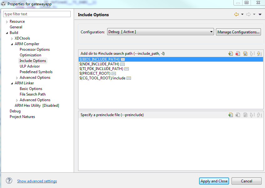

I am not very sure as to what the cause of these errors might be, as all my header files seems to included correctly and contains the necessary declarations as well. Does seems as if the ARM linker is not linking the correct libraries (if linking any at all). However I am confused to what exact libraries to link it to:
The includes path can also be seenbelow:
I would greatly appreciate any assistance or advise as to what the cause of these problems might be, so that I can get these errors fixed. The complete project is also attached in the following .zip file if you would wish to try an reproduce the error: gatewayapp_test.zip

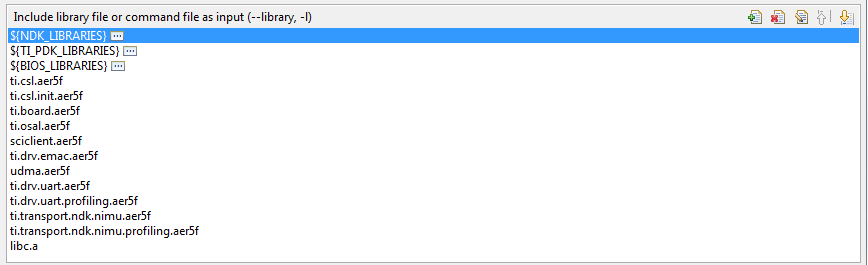

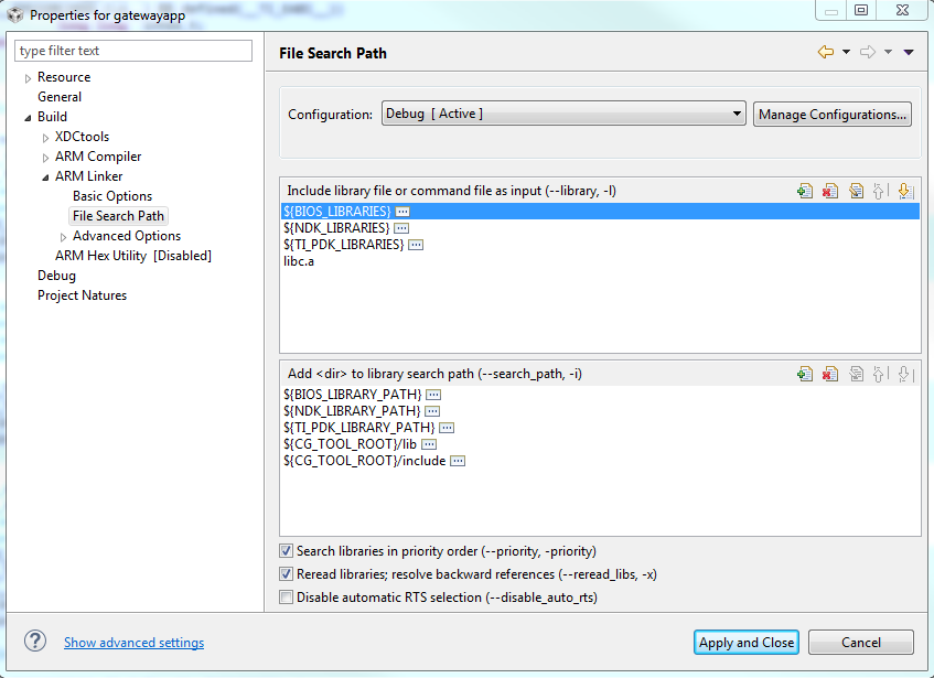

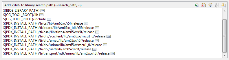

    So I seem to have made some progress regarding this.
    Under Project->Properties->ARM Linker->File Search Path I added the search paths to the library files of all the drives mentioned in http://software-dl.ti.com/processor-sdk-rtos/esd/docs/latest/rtos/index_examples_demos.html#can-eth-gatway-demo. These added paths can be seen in the screenshot below:
    I also added the following libraries from these included paths, which can be seen below:
    This solves most of the errors of the form: "unresolved symbol Board_init, first referenced in ./gateway_main.obj gatewayapp". However I am still struggling to figure out where these errors that I am still getting are coming from regarding the OSAL drive.
    For example symbol "Osal_free" redefined: first defined in "./gateway_osal.obj"; redefined in "./utils_prf.obj" null: symbol "Osal_free" redefined: first defined in "./gateway_osal.obj"; redefined in "./utils_prf.obj"

  • Hi Johnny,
    The OSAL_free redefined issue was cause by the inclusion of gateway_osal.c in your project. If you check the processor_sdk_rtos_am65xx_5_03_00_07\demos\gateway-demos\can-eth-gateway\build\makefile.mk, you will see the utils_prf.c is included, but gateway_osal,c is not.
    Ming
