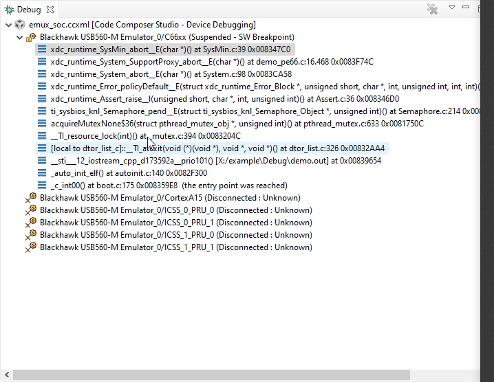

I have a problems with setting up NDK.
If i have NDK enabled and use any kind of print and additionally enable the compiler option --multithread the program gets stuck before main.
I tried to debug and this is what I found out:
  • during initialisation of std::cout some stream-buffer gets allocated
  • this is directed to a pthreads lock
  • during accessing the semaphore of the lock the BIOS_getThreadType returns not TASK
  • this leads to an assert
I have created a test project that just prints on the CCS console. You can select between 3 print modes:
  • XDC System_printf
  • C printf
  • C++ std::cout
This is working fine as long as the --multithread option is not set. If i enable it i no longer have dumps or even are not able to reach main.
I need help to figure out what is wrong. I already tried to set BIOS.rtsGateType to GateSwi that did not help completely.
Can someone try to reproduce and have a look at my CFG file, please?demo.zip
