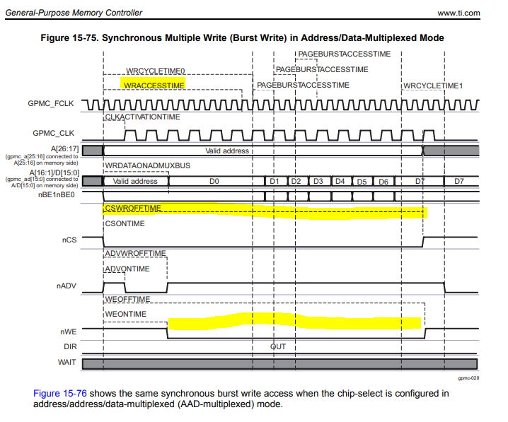

    Customer read some article about GPMC (Not TI e2e or AM57 document) at write mode.
    "WRACCESSTIME " have to set small value than CSWROFFTIME and WEOFFTIME.
    This doesn't depend on Async or sync.
    Then, they could fix this issue.
    However, we would like to confirm if this restriction is correct.
    According to this parameter WRACCESSTIME seems smaller than CSWROFFTIME and WEOFFTIME.
    However, there is no comment for this restriction.
    Do we have such a restriction ?

  • Hi Kaz-san,
    For synchronous writes, WRACCESSTIME needs to be set to the rising edge of GPMC_FCLK corresponding to the rising edge of GPMC_CLK when the memory device latches the incoming data driven on the data bus by the GPMC. nWE needs to have already been asserted low when this rising edge of GPMC_CLK occurs. And nWE needs to remain low for the CLK-to-nWE hold time requirement specified in the datasheet of the memory device.
    For asynch memories, usually the nWE signal rising edge is used as the latching event for data being written by the GPMC. In this case, I believe WRACCESSTIME and WEOFFTIME might be the same.
    If the memory provides a signal to the WAIT pin, WrAccessTime is used as a WAIT invalid timing window. It must be set to a value such that the WAIT pin is at a valid state two GPMC clock cycle before WrAccessTime.
    In any case, CSWROFFTIME and WRCYCLETIME need to occur after WRACCESSTIME and nWE deassertion.
    For the figure you attached, there is a text description that states the programmed value of WRCYCLETIME equals WRCYCLETIME0 + WRCYCLETIME1. WRCYCLETIME0 and WRCYCLETIME1 delays are not actual parameters and are only a graphical representation of the full WRCYCLETIME value.
    Mark
  • Hi Mark,
    Sorry, I have some feed back from customer.
    >For asynch memories, usually the nWE signal rising edge is used as the latching event for data being written by the GPMC. In this case, I believe >WRACCESSTIME and WEOFFTIME might be the same.
    -Customer condition set WRACCESS TIME < WEOFFTIME. Then, their application seems working. Do we have to set same value for these parameters ?
    after WRACCESSTIME and nWE de-assertion, is it able to happen  CSWROFFTIME and WRCYCLETIME after 1cycle later ?
  • Hi Kaz-san,
    This is fine. WRACCESSTIME does not NEED to be the same as WEOFFTIME. The data will remain on the GPMC data bus until WRCYCLETIME completes.
    It is more important for the WAIT signal - Is the customer using the WAIT signal?
    Yes, this is permissible. The GPMC section Read Cycle Time and Write Cycle Time (RDCYCLETIME / WRCYCLETIME) in the TRM specifies...
    "When RDCYCLETIME or WRCYCLETIME completes, if they are not already deasserted, all control signals (nCS, nADV/ALE, nOE/RE, nWE, and BE0/CLE) are deasserted to their reset values, regardless of their deassertion time parameters."
    So if CSWROFFTIME occurs at the same time as WRCYCLETIME, the CSn signal will go high/deasserted.
    But I want to make you aware of this wiki that states that CSWROFFTIME must be less than WRCYCLETIME. See Rule 8 here http://processors.wiki.ti.com/index.php/Tips_for_configuring_OMAP35x,_AM35x,_and_AM-DM37x_GPMC_registers
    Sorry I do not have the background about this rule.
    Mark
  • Hi Mark,
    Thank you for reply.
    - Yes, Customer is using "WAIT signal". In this case , do they have to set same value for WRACCESSTIME and WEOFFTIME ?
    Kz777
  • Hi Kaz-san,
    No, this means that the WRACCESSTIME must occur before WEOFFTIME by enough GPMC_FCLK cycles so that the GPMC_WAIT pin is at a valid state at least 2 GPMC_CLK cycles before WRACCESSTIME completes.
    Note that the period of 1 GPMC_CLK cycle = the period of 1 GPMC_FCLK cycle * (GpmcFCLKDivider + 1).
    Also note that the WRACCESSTIME and WEOFFTIME values are in GPMC_FCLK cycles.
    Mark
