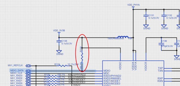

Hello Support,
1. Why does the am335x-bone-common.dtsi file for the BBB initialize the MDIO_DATA with its internal pull-up enabled knowing that an external 1.5K pull-up resistor (R119) is already connected to the node where MDIO_DATA is connected?
The initialization we found is the following:
AM33XX_IOPAD(0x948, PIN_INPUT_PULLUP | SLEWCTRL_FAST | MUX_MODE0) /* mdio_data.mdio_data */
And the schematic shows the following:
...and same happens with other interfaces, for example, the MMC0 interface (micro-sd) where all the data bus pins have external 10K pull-ups resistors and, however, the device tree enables all the internal pull-ups for those pins:

  • Hi Juan,
    Having both (internal and external) pullup options should not  be an issue. In some cases mdio_data internal pullup resistor might be too weak, thus BBB designers  added external pullup.
