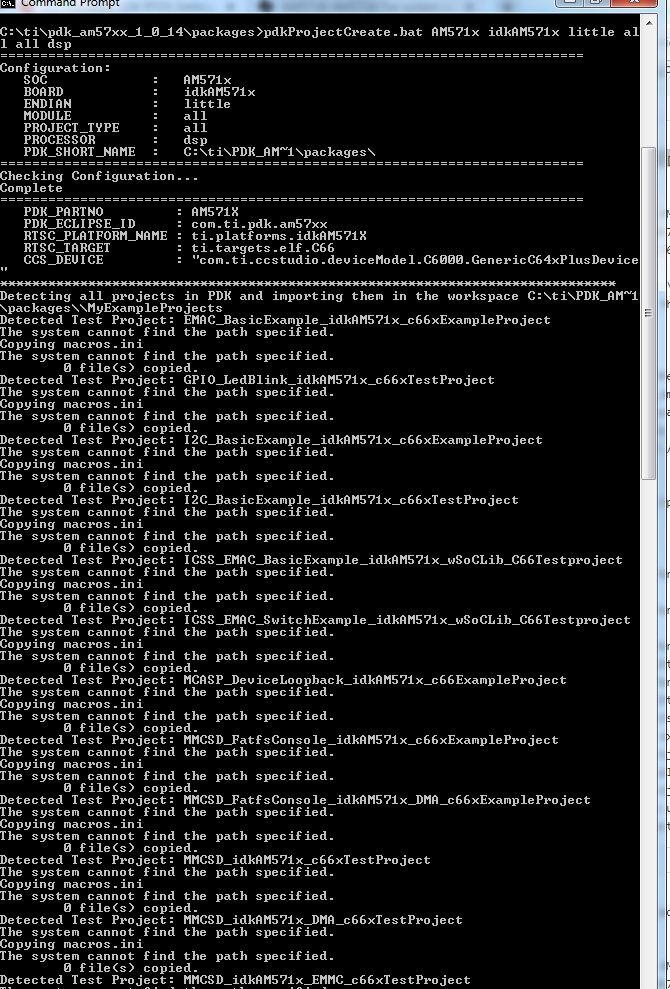

I am new to idkAM571x board. I want to use idkAM571x for my development process.
But I am not able to run the SDK examples.
When I am creating the project as per guideline given in "http://software-dl.ti.com/processor-sdk-rtos/esd/docs/latest/rtos/index_overview.html#setup-environment" I am getting the following message. Kindly help me.
The system cannot find the path specified.

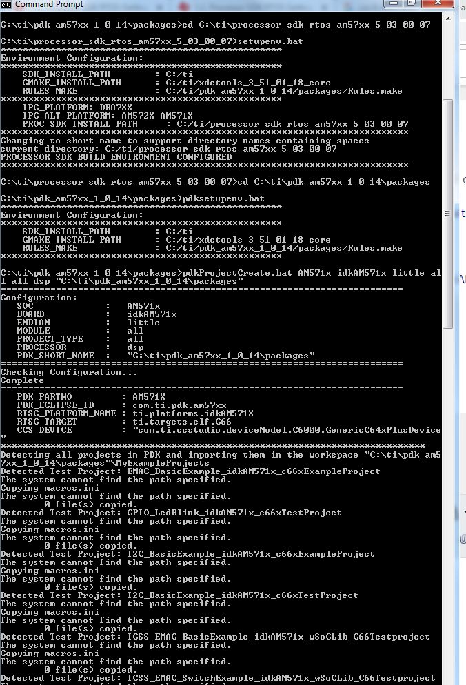

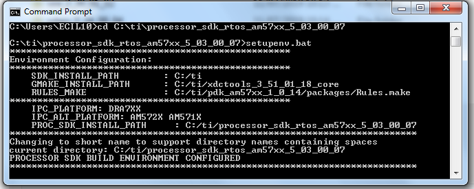

  • I have done this on windows
    after that I have configured the pdk also. The message is attached here.
    After that When I am creating the project, I am getting the error.
    Please guide me what to do.

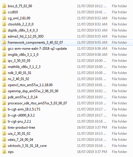

    The versions I am using is given in figure below
  • Sorry the rtos build image is given below

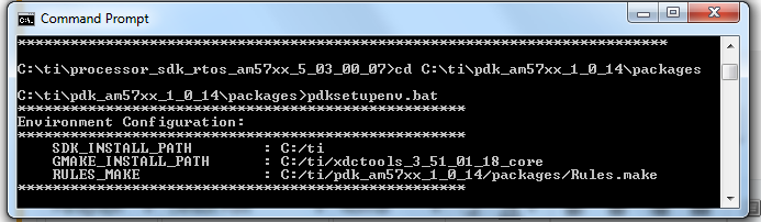

  • Singh,
    Please run the commands in the below order and if issue still occur, provide me the console output messages.
    C:\ti\processor_sdk_rtos_am57xx_5_03_00_07> setupenv.bat
    C:\ti\pdk_am57xx_1_0_14\packages> pdksetupenv.bat
    C:\ti\pdk_am57xx_1_0_14\packages> pdkProjectCreate.bat AM571x idkAM571x little all all dsp "C:\ti\pdk_am57xx_1_0_14\packages"
    Pavel

  • thanku for ur help,
    Actually the problem was ccs version. I was using cc9, when I used ccs8 the problem solved.
