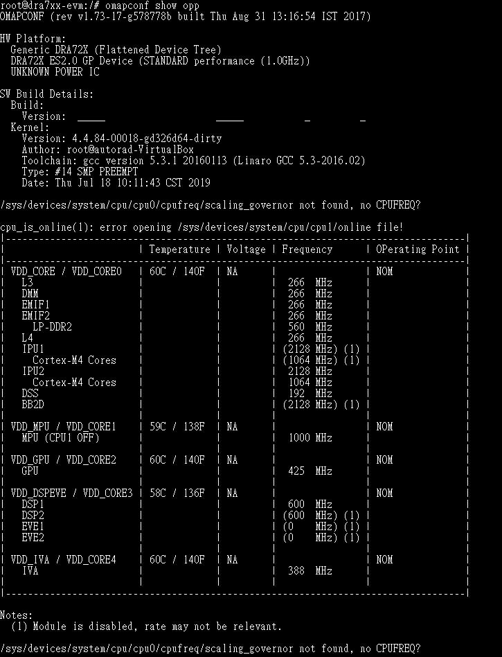

I try to run omapconf show opp,but it show scaling_governor not found.
If I want to use this to chane frequency,what I need to set up?

Hi Yordan
I had been to use menuconfig to change governor.
When I use menuconfig ,then use make linux_install and copy uImage to SD card.
But omapconf show opp still show no find scaling governor.

HI
Can you confirm if the kernel configuration used is similar to that of the Linux SDK - would help if you can mention the SDK/kernel version.
You can check the kernel configuration by typing # zcat /proc/config.gz

Hi
the verison is 4.4.84-00018-gd326d64-dirty
I use tda2eg sdk302.

Hi Sriram
I cannot to verify the kernel configuration by running the zcat /proc/config.gz.
I even cannot find config.gz. file.

Hi
Config.gz file is exported at runtime if the corresponding kernel configuration option to include it the kernel image is enabled. It is enabled by default in the TI SDK - have you modified the kernel configuration at your end. If so can you verify the changes carried out - including selection of options for CPUFREQ, governors
