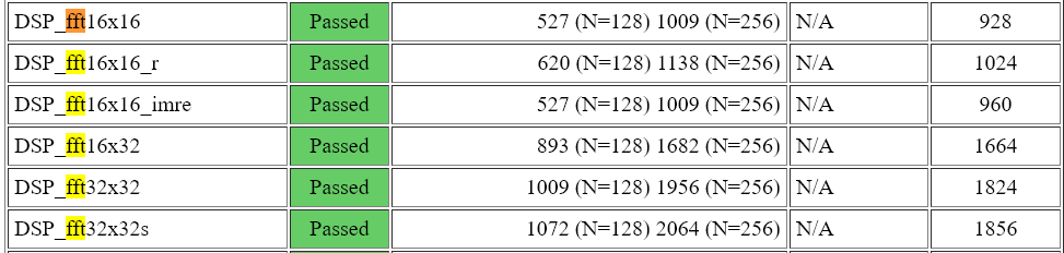

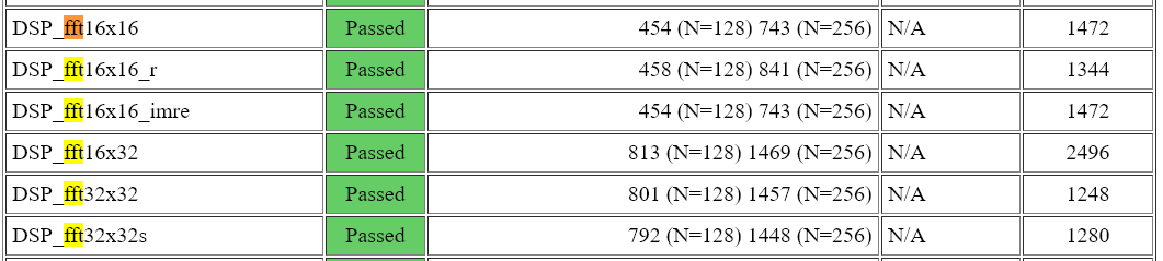

    BAsed on your comment, I checked the reported numbers reported for DSP_fft32x32 for DSPLIB C64x and DSPLIB C66x and the numbers seem to indicate 20% improvement.
    C64x DSPLIB:
    C66x DSPLIB:

    about comparison between 6678 and 6455, we compared them for INT32 as you mentioned. but in case of 6455 we used "sprueb8b.pdf" as reference which shows less than 20% improvement. (honestly we expect improvement over 30% in 6678)
