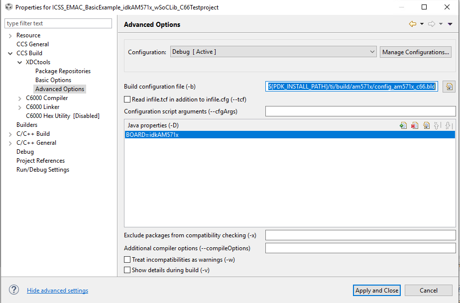

Hello
I am working on AM5718IDK. I have a requirement to use the subset of ICSS_EMAC_BasicExample_idkAM571x_wSoCLib_C66Testproject example project with MAC to MAC communication from DSP. For that, I have modified the existing auto generated project(pdkProjectCreate.bat)  and working fine. Then I have developed a new BIOS project from existing modified source code. I have included platform as ti.platforms.idkAM571X and C:\ti\pdk_am57xx_1_0_13\packages\ti\build\pruss\lnk_c66_m4_REV2.cmd linker file as you added in the original sample project.
while compering the linker file generated by project
orginal project
-l"E:\SDR-MP-SC\pru1_2\ICSS_EMAC_BasicExample_idkAM571x_wSoCLib_C66Testproject\Debug\configPkg\package\cfg\icss_emac_c66_wSoCLib_pe66.oe66"
-l"C:\ti\pdk_am57xx_1_0_13\packages\ti\drv\icss_emac\test\am571x\c66\bios\src\sysbios\sysbios.ae66"
-l"C:\ti\pdk_am57xx_1_0_13\packages\ti\drv\pruss\lib\am571x\c66\release\ti.drv.pruss.ae66"
-l"C:\ti\pdk_am57xx_1_0_13\packages\ti\drv\icss_emac\lib\am571x\c66\release\ti.drv.icss_emac.profiling.ae66"
-l"C:\ti\pdk_am57xx_1_0_13\packages\ti\board\lib\idkAM571x\c66\release\ti.board.ae66"

my new project
-l"E:\SDR-MP-SC\pru1_2\icss_emac_ethernet\Debug\configPkg\package\cfg\icss_emac_c66_wSoCLib_pe66.oe66"

 while building my new project following error message is coming

Building target: "icss_emac_ethernet.out"
Invoking: C6000 Linker
"C:/ti/ti-cgt-c6000_8.2.2/bin/cl6x" -mv6600 --define=USE_BIOS --define=SOC_AM571x --define=idkAM571x --define=C66X --define=am5718 -g --diag_warning=225 --diag_wrap=off --display_error_number -z -m"icss_emac_ethernet.map" --heap_size=0x800 --stack_size=0x800 -i"C:/ti/pdk_am57xx_1_0_13/packages/ti/drv/pruss/lib/am571x/c66/release" -i"C:/ti/ti-cgt-c6000_8.2.2/lib" -i"C:/ti/ti-cgt-c6000_8.2.2/include" --reread_libs --diag_wrap=off --display_error_number --warn_sections --xml_link_info="icss_emac_ethernet_linkInfo.xml" --rom_model -o "icss_emac_ethernet.out" "./source/icss_emacFwConfig.obj" "./source/main_dsp.obj" "./source/test_common_utils.obj" -l"configPkg/linker.cmd" -lti.drv.pruss.ae66 -l"C:/ti/pdk_am57xx_1_0_13/packages/ti/build/pruss/lnk_c66_m4_REV2.cmd" -l"C:/ti/pdk_am57xx_1_0_13/packages/ti/drv/icss_emac/firmware/icss_dualemac/bin/am571x/c66x/REV2/icss_dualemac_PRU0.bin" -l"C:/ti/pdk_am57xx_1_0_13/packages/ti/drv/icss_emac/firmware/icss_dualemac/bin/am571x/c66x/REV2/icss_dualemac_PRU1.bin" -llibc.a
<Linking>
"configPkg/linker.cmd", line 175: warning #10097: memory range not found: APP_CACHED_DATA_BLK1_MEM on page 0
"configPkg/linker.cmd", line 175: error #10265: no valid memory range(null) available for placement of ".fardata"
"configPkg/linker.cmd", line 175: error #10099-D: program will not fit into available memory. run placement with alignment fails for section ".fardata" size 0x4002cce
"configPkg/linker.cmd", line 161: warning #10097: memory range not found: APP_CODE_MEM on page 0
"configPkg/linker.cmd", line 161: error #10265: no valid memory range(null) available for placement of ".text"
"configPkg/linker.cmd", line 161: error #10099-D: program will not fit into available memory. placement with alignment fails for section ".text" size 0x25e20
"configPkg/linker.cmd", line 173: warning #10097: memory range not found: APP_CACHED_DATA_MEM on page 0
"configPkg/linker.cmd", line 173: error #10265: no valid memory range(null) available for placement of ".const"
"configPkg/linker.cmd", line 173: error #10099-D: program will not fit into available memory. placement with alignment fails for section ".const" size 0x377b
"C:/ti/pdk_am57xx_1_0_13/packages/ti/build/pruss/lnk_c66_m4_REV2.cmd", line 18: warning #10097: memory range not found: APP_CACHED_DATA_BLK1_MEM on page 0
"C:/ti/pdk_am57xx_1_0_13/packages/ti/build/pruss/lnk_c66_m4_REV2.cmd", line 14: error #10265: no valid memory range(null) available for placement of "PRU0_REV2_DMEM"
"C:/ti/pdk_am57xx_1_0_13/packages/ti/build/pruss/lnk_c66_m4_REV2.cmd", line 14: error #10099-D: program will not fit into available memory. run placement with alignment fails for section "PRU0_REV2_DMEM" size 0x2000
"C:/ti/pdk_am57xx_1_0_13/packages/ti/build/pruss/lnk_c66_m4_REV2.cmd", line 13: warning #10097: memory range not found: APP_CACHED_DATA_BLK1_MEM on page 0
"C:/ti/pdk_am57xx_1_0_13/packages/ti/build/pruss/lnk_c66_m4_REV2.cmd", line 9: error #10265: no valid memory range(null) available for placement of "PRU0_REV2_IMEM"
"C:/ti/pdk_am57xx_1_0_13/packages/ti/build/pruss/lnk_c66_m4_REV2.cmd", line 9: error #10099-D: program will not fit into available memory. run placement with alignment fails for section "PRU0_REV2_IMEM" size 0x2000
"C:/ti/pdk_am57xx_1_0_13/packages/ti/build/pruss/lnk_c66_m4_REV2.cmd", line 31: warning #10097: memory range not found: APP_CACHED_DATA_BLK1_MEM on page 0
"C:/ti/pdk_am57xx_1_0_13/packages/ti/build/pruss/lnk_c66_m4_REV2.cmd", line 27: error #10265: no valid memory range(null) available for placement of "PRU1_REV2_DMEM"
"C:/ti/pdk_am57xx_1_0_13/packages/ti/build/pruss/lnk_c66_m4_REV2.cmd", line 27: error #10099-D: program will not fit into available memory. run placement with alignment fails for section "PRU1_REV2_DMEM" size 0x2000
"C:/ti/pdk_am57xx_1_0_13/packages/ti/build/pruss/lnk_c66_m4_REV2.cmd", line 26: warning #10097: memory range not found: APP_CACHED_DATA_BLK1_MEM on page 0
"C:/ti/pdk_am57xx_1_0_13/packages/ti/build/pruss/lnk_c66_m4_REV2.cmd", line 22: error #10265: no valid memory range(null) available for placement of "PRU1_REV2_IMEM"
"C:/ti/pdk_am57xx_1_0_13/packages/ti/build/pruss/lnk_c66_m4_REV2.cmd", line 22: error #10099-D: program will not fit into available memory. run placement with alignment fails for section "PRU1_REV2_IMEM" size 0x2000
"C:/ti/pdk_am57xx_1_0_13/packages/ti/build/pruss/lnk_c66_m4_REV2.cmd", line 21: warning #10097: memory range not found: APP_CACHED_DATA_BLK1_MEM on page 0
"C:/ti/pdk_am57xx_1_0_13/packages/ti/build/pruss/lnk_c66_m4_REV2.cmd", line 19: error #10265: no valid memory range(null) available for placement of "PRU0_REV2_EXT"
"C:/ti/pdk_am57xx_1_0_13/packages/ti/build/pruss/lnk_c66_m4_REV2.cmd", line 19: error #10099-D: program will not fit into available memory. run placement with alignment fails for section "PRU0_REV2_EXT" size 0x1000
"C:/ti/pdk_am57xx_1_0_13/packages/ti/build/pruss/lnk_c66_m4_REV2.cmd", line 34: warning #10097: memory range not found: APP_CACHED_DATA_BLK1_MEM on page 0
"C:/ti/pdk_am57xx_1_0_13/packages/ti/build/pruss/lnk_c66_m4_REV2.cmd", line 32: error #10265: no valid memory range(null) available for placement of "PRU1_REV2_EXT"
"C:/ti/pdk_am57xx_1_0_13/packages/ti/build/pruss/lnk_c66_m4_REV2.cmd", line 32: error #10099-D: program will not fit into available memory. run placement with alignment fails for section "PRU1_REV2_EXT" size 0x1000
"configPkg/linker.cmd", line 185: warning #10097: memory range not found: APP_CACHED_DATA_MEM on page 0
"configPkg/linker.cmd", line 185: error #10099-D: program will not fit into available memory. run placement with alignment fails for section ".plt" size 0x0
"configPkg/linker.cmd", line 189: warning #10097: memory range not found: APP_CACHED_DATA_MEM on page 0
"configPkg/linker.cmd", line 189: error #10099-D: program will not fit into available memory. placement with alignment fails for section "xdc.meta" size 0x100
../../master/ELFLNK/build.c:2612:internal fatal error #10251: ("xdc.meta:icss_emac_c66_wSoCLib_pe66.oe66")

  • Satheesh,
    You need to add the config_am571x_c66.bld file from PDK /ti/build/am571x in your new CCS project. To add the .bld file, see below screen capture:
    Garrett
