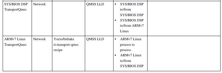

  • Hi, Yordan,
          Thanks for your reply again!
          SDK RTOS + IPC support  "ARM and DSP run sysbios  all?"
          In the document "Processor SDK RTOS IPC Transports.pdt",  I find:
         I do not see  the case of  “ARM and DSP run sysbios  all”。
         Help confirm, please! Thank you!

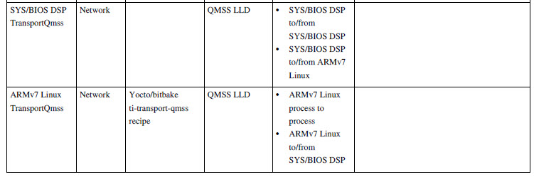

  • Hi, Yordan,

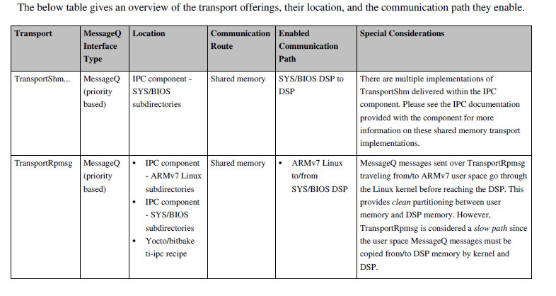

  • Hi, Yordan,
        In the document "Processor SDK RTOS IPC Transports.pdt", the content "The below table gives an overview of the transport offerings, their location, and the communication path they enable.". I do not see the case of “ARM and DSP run sysbios all”。
        Thank you!

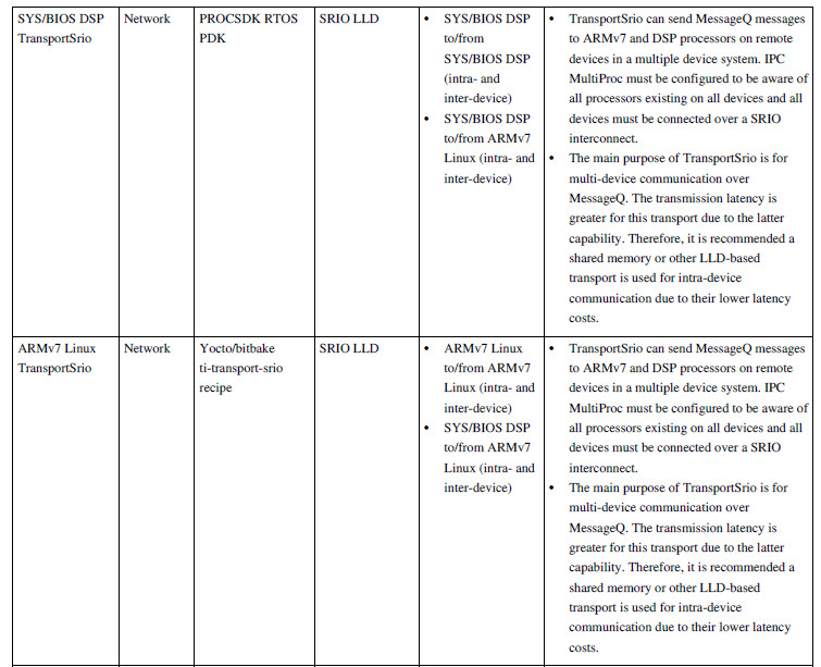

  • Hi, Yordan,
        "Processor SDK RTOS IPC Transports.pdf" describes below:
               I do not see that IPC support the path "ARM SYS/BIOS to/from SYS/BIOS DSP ".    So, does it  mean that IPC not support the case?
             Help confirm,please!
             Thank you!
    You can take a look at the latest Processor SDK RTOS documentation:
    If you follow the link to the IPC wiki (processors.wiki.ti.com/.../IPC_Users_Guide), you will see in the About this User's Guide section a link to the IPC use cases:
    You will see that BIOS-to-BIOS is supported scenario in IPC. Now for the particular OMAP-L138 devices this may not have been implemented in the examples, but IPC provides the needed APIs to do BIOS-to-BIOS communication, so you should be able to implement it.
    Yordan

  • Hi, Yordan,
    IPC Users Guide,  does not describe this question.
    But,  From “IPC 3.40.01.08 Release Notes”,  describes below:
             1.This IPC Release is targeted to SYS/BIOS 6-based platforms.
             2.The IPC product provides software connectivity between multiple processors. Each processor may run either an HLOS (e.g. Linux, QNX) or an RTOS (e.g. SYS/BIOS).
             3.IPC 3.40.01.08 requires system integrators to update the following dependencies:
                      XDC Tools 3.31.02.38.core (or compatible)
                     SYS/BIOS 6.42.02.29 (or compatible)
    I think,  it means that  IPC do not support  DSP/BIOS.
    I answered to your last question on this e2e thread:
    Short answer is, yes, your understanding is correct.
    Yordan
