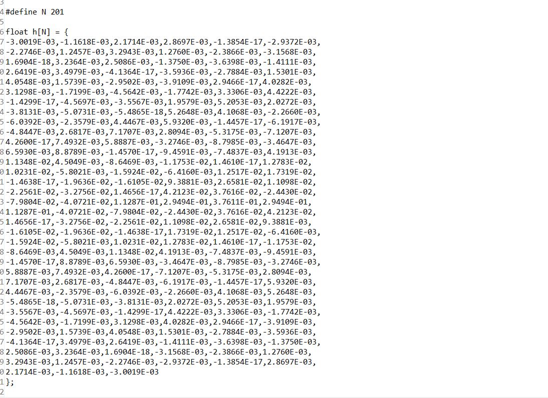

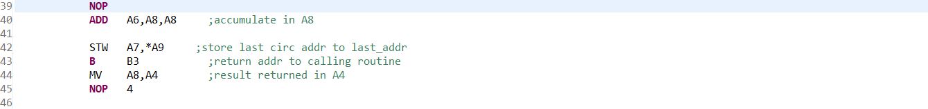

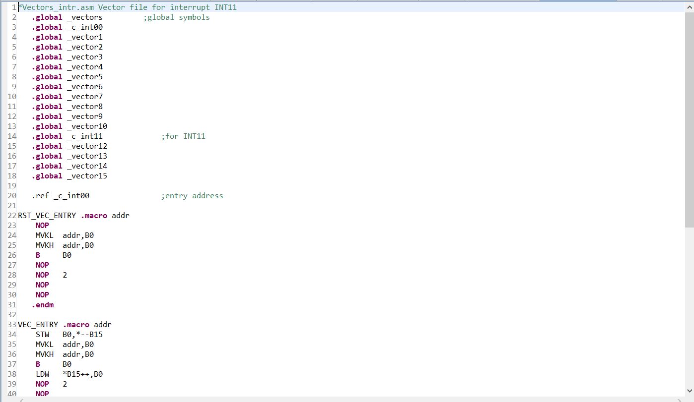

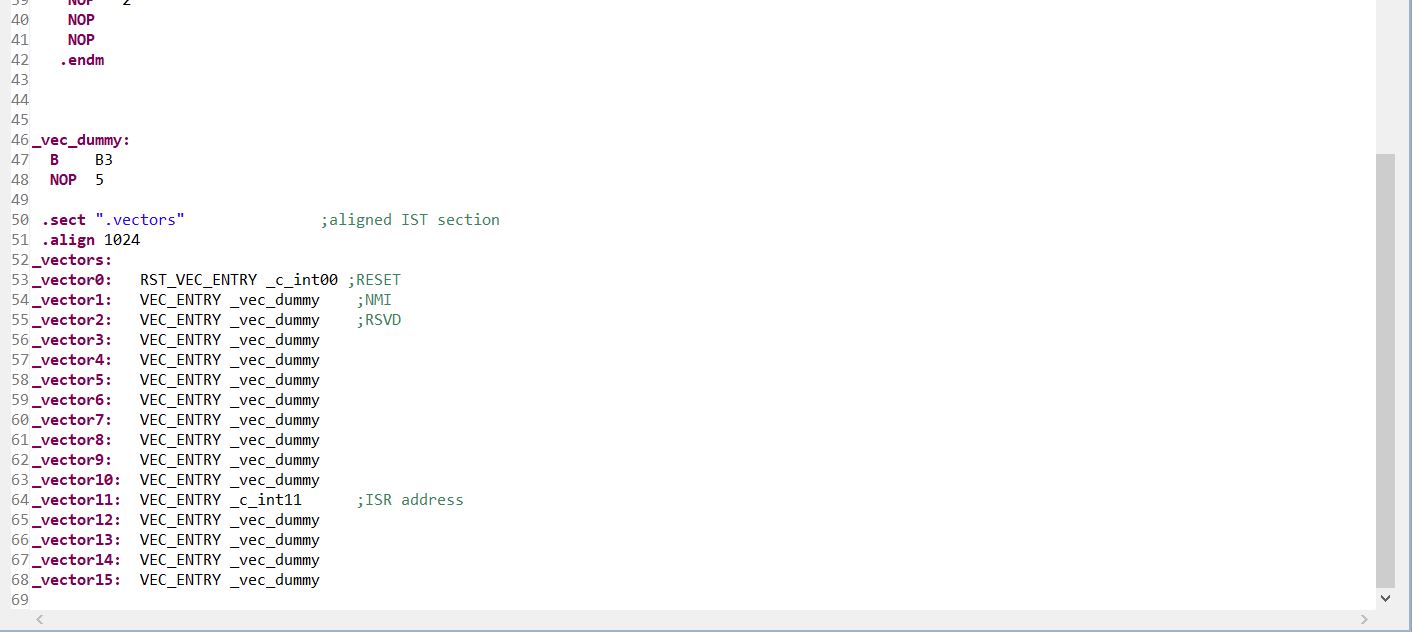

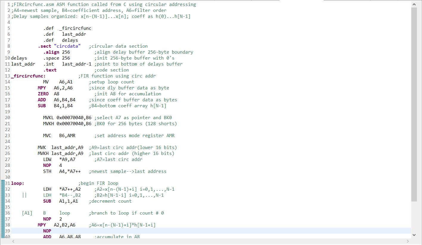

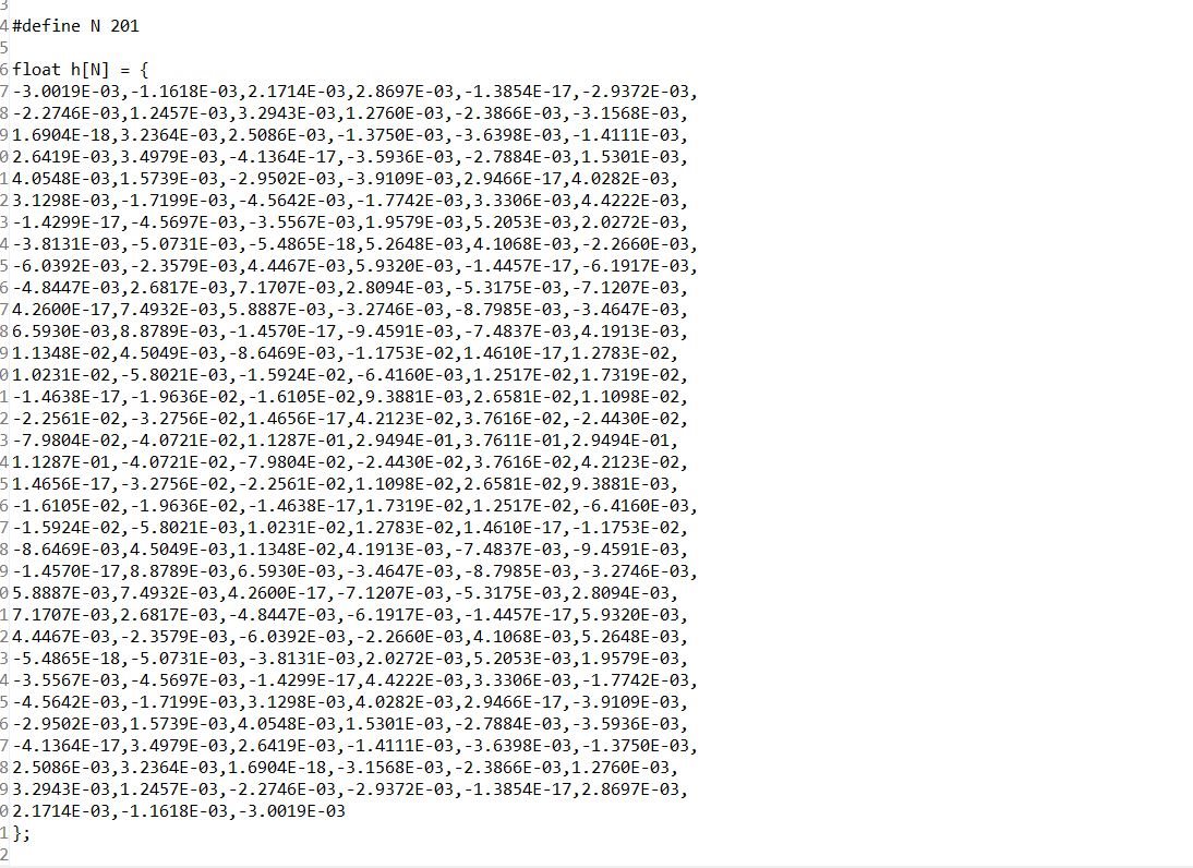

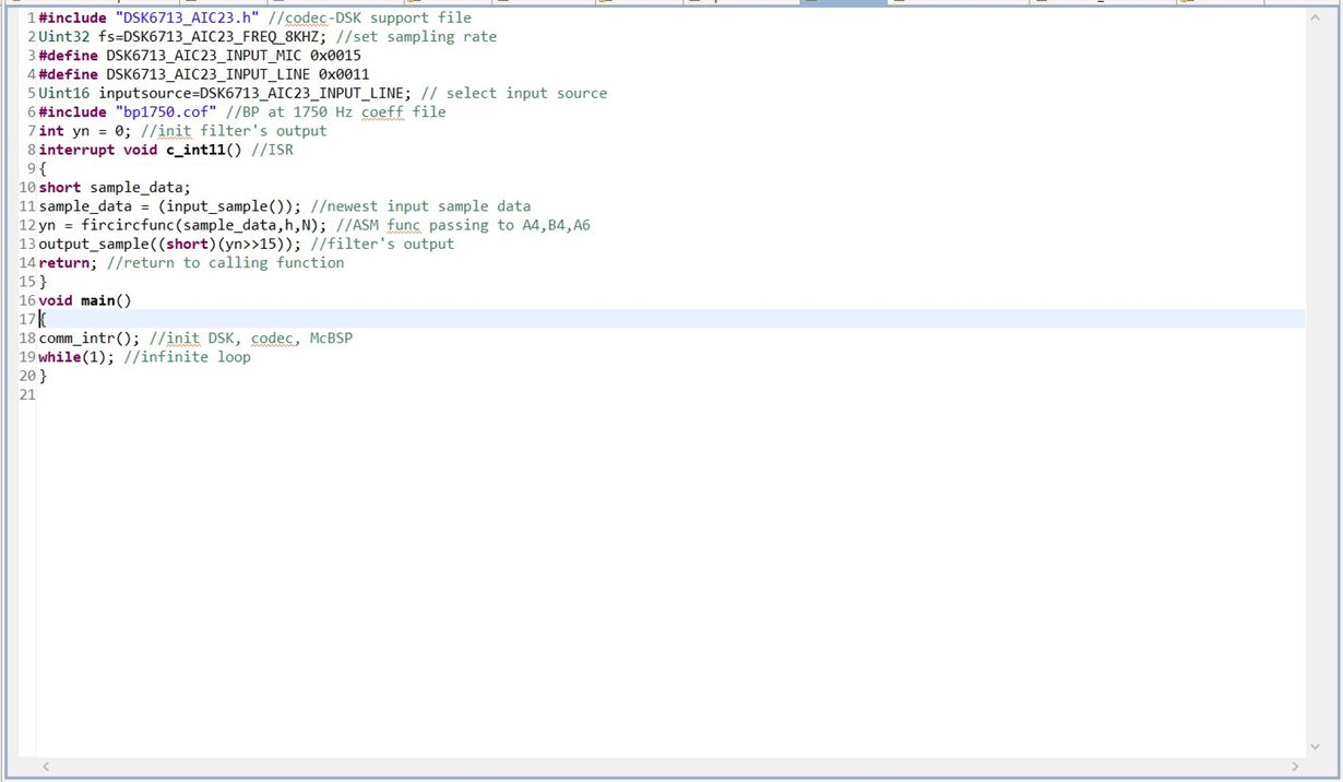

Respected Members,
                                 I am trying to implement higher order Fir filter using Circular buffer.I found out this example from book named "Digital Signal Processing and Applications with the TMS320C6713 and TMS320C6416 DSK"
This example uses .asm file to implement Filter. when i implement this example it is just giving me noise. my task is to implement some higher order filter of 200 or more. i am attaching my code ,asm file and screen shots of oscilloscope and signal generator. please let me know where is problem. i also tried to implement fir lowpass filter using blackmann window. but its just noise
