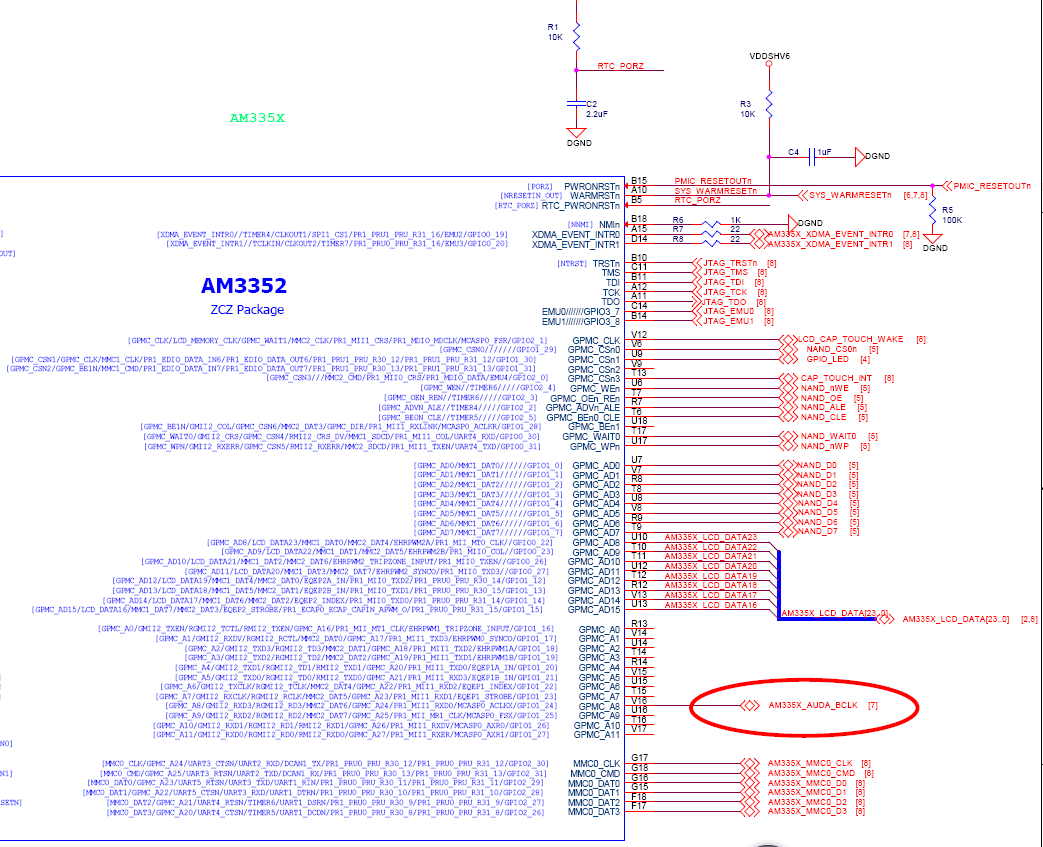

Writing failures occur when using nandwrite instructions in MTD util tools
The NAND flash GPMC pinmux settings are as follows
When I erase and write Flash, I use an oscilloscope to measure the Wpn pin, which is always high level without write protection.
But after calling nandwrite to write flash, there are a lot of errors, as shown below.
So I added some test code to the driver of kernel, found that it was often considered to have write protection at the function nand_check_wp. What is the reason for this phenomenon?

    I'm not the same as the above posts, and I checked the configuration, asynchronous reading and writing.
    Here's our schematic , pinmux settings , gpmc register value and dts settings.
    I found a phenomenon.
    The following code adds printk statement, using nandwrite everything is normal, if you turn off debugging information or do not add this sentence, there will be an exception before.

    I am wondering if you could please confirm the NAND datasheet to ensure write protect pin is configured correctly.
