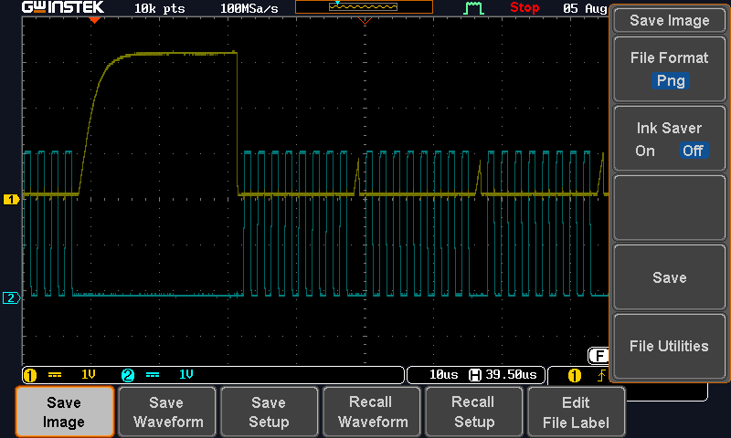

we are trying to use the BeagleBoard-X15's McSPI4 with the Linux spidev driver (TI SDK 5.03), but we get some confusing signals on the MOSI line. SCLK and CE lines are working as expected.
Following is the Pinmux setup for McSPI4 generated with the pearl script:
{MMC3_DAT4, (M1 | PIN_OUTPUT_PULLUP)},	/* mmc3_dat4.spi4_sclk */
{MMC3_DAT5, (M1 | PIN_OUTPUT_PULLUP)},	/* mmc3_dat5.spi4_d1 */
{MMC3_DAT6, (M1 | PIN_OUTPUT_PULLUP)},	/* mmc3_dat6.spi4_d0 */
{MMC3_DAT7, (M1 | PIN_OUTPUT_PULLUP)},	/* mmc3_dat7.spi4_cs0 */
The device tree node for McSPI/spidev:
&mcspi4 {
	pinctrl-names = "default";
	status = "okay";
	spidev@0{
		compatible = "rohm,dh2228fv";
		spi-max-frequency = <48000000>;
		reg = <0x0>;
		ti,pindir-d0-out-d1-in;
		#ti,pindir-d0-in-d1-out;
		status = "okay";
And the output on MOSI line using linux/tools/spi/spidev_test.c:
It seems like there are two signals on this pin? We are measuring directly on the expansion connectors using a Hirose FX18-60S-0.8SV15.
We also checked IO_SET4 with the same behaviour.
Another problem is, that there are no changes on the pins if we try to switch the SPI D0 and D1 pins for input and output using the out commented line in the device tree SPI node above.
Any hints on solving these problems?

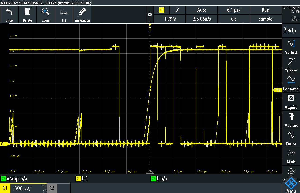

    I edited the line in mux_data.h to{MMC3_DAT5, (M1 | PIN_INPUT_PULLUP)}, now the MOSI signal looks much better.
    But it seems like there are still some problems driving the pin.
    In the first picture you see a very long rise time to high state between two spi write operations.
    The MOSI pin is pulled high after sending 8 bits, but it never reaches high state.

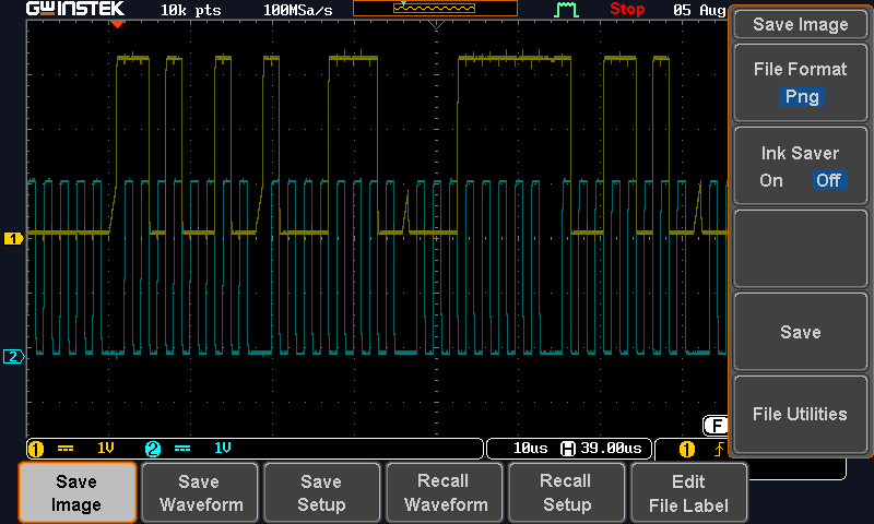

  • Yes, the mcspi4_d0 signal looks not as it should.
    I just tried the MOSI/D0 without pullup with the same issue described above.

    This does not look correct.
    [16] DPE0 = 1
    [17] DPE1 = 0
    [18] IS = 0
    This configuration is for mcspi4_d0 input and mcspi4_d1 output.
    Please modify your DTS file like below and try again.
    &mcspi4 {
        - pinctrl-names = "default";
        status = "okay";
           + ti,pindir-d0-out-d1-in;
        spidev@0{
            reg = <0x0>;
             - ti,pindir-d0-out-d1-in;
             - #ti,pindir-d0-in-d1-out;
             - status = "okay";
  • The device tree modification solved it. The signal looks much better and the SPI slave is already working. Thank you very much!
