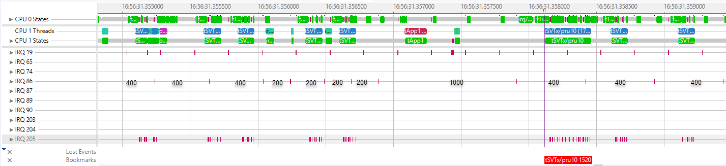

I did some measurements with the RX pacing on the GMAC eth0 interface.
As input (rx data) we have two 2.4kHz streams and one 1.2kHz stream.
That means we receive in a 1ms time frame between 5 and 7 packets.
Rx pacing is set to 500us:

I did a measurement with LTTNG. On the Trace Compass Resource diagram screenshot I added the time between the eth0 interrupts (IRQ/86, numbers are in us).
Could you explain why we see this three different gaps between the IRQ/86 interrupts (200us, 400us and 1000us)?
It seems that we have a dynamic setting of the Rx pacing during run time, even though I have set the pacing to 500.
Could you explain more in detail the algorithm which is used.

    The reason for the different gaps that you are seeing is that with the CPSW driver NAPI scheduling (polling) is being used to schedule RX processing. There are two different methods to schedule RX packet processing, interrupt based and NAPI scheduling.
    When using the NAPI scheduler the interrupts do not directly trigger RX processing. The NAPI scheduler will do some interrupt pacing on its own as it is designed to increase throughput and reduce overhead at the cost of packet processing latency.  So using interrupt pacing while using NAPI is kind of a conflict in some respects as both approaches are trying to achieve the same result of reducing Interrupt processing overhead.
    Whether NAPI scheduling is used or enabling interrupt processing depends on what the application is trying to do. If the application requires high network throughput then NAPI scheduling should be used. This is what TI uses as a default and tests. If the application requires a more deterministic processing and there is a low network bandwidth requirement then interrupt processing could be used. Interrupt pacing would work better in interrupt processing mode. TI does not test this currently.

  • The ISR Pacing block is an adaptive interrupt pacing block. That is it will adapt the interrupt rate to the desired rate by adjusting the delays based on the current interrupt load. Based on thresholds it may saturate, double, increment, decrement or half the current interrupt delay steps as to adapt the interrupt delay to meet the desired rate. The thresholds are generated from the programmed desired rate. The delay steps are the 4uS steps defined by the prescaler. This method allows the selected ISR to correct the interrupt load very quickly and target the desired ISR rates while keeping the latency to the first events extremely low. The adaptation updates the rate every 250 4uS tics based on the current rate. In the event that the current interrupt rate is greater than two times the desired rate prior to the next update, the full saturation delay will be added and the 250 4uS tics will be restarted. So if you programmed the rate to be 5K, but an attempt of 20K occurred, you would see 10 interrupts followed by 1024uS delay due to the saturation case, then quickly asymptotes to 5 interrupts per millisecond.
  • PS: The lower the programmed rate, the courser the correction. The higher the programed rate the finer the correction.
