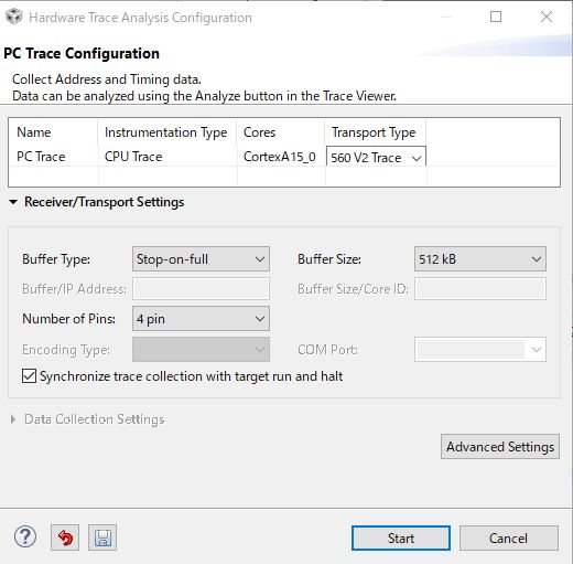

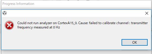

Is tpiu trace possible in the following environment?
emulator: TMDSEMU560v2STM-U
connector: TI 20-Pin CTI
1 TMS
2 TRST
3 TDI
4 TDIS
5 VTRef
6 KEY
7 TDO
8 GND
9 RTCK
10 GND
11 TCK
12 GND
13 EMU0
14 EMU1
15 RESET
16 GND
17 EMU2
18 EMU3
19 EMU4
20 GND
EMU0=tpiu_data0
EMU1=tpiu_data1
EMU2=tpiu_clk
EMU3=tpiu_ctrl
EMU4=tpiu_data2
EMU5=tpiu_data3
I am executing the Configure_EMU0_4_For_TPIU() function of the following gel.
C:\ti\ccsv8\ccs_base\emulation\boards\am571x\gel\AM571x_tpiu.gel
Also, does it support 1pin mode trace?
EMU0=tpiu_data0
EMU1=tpiu_clk
