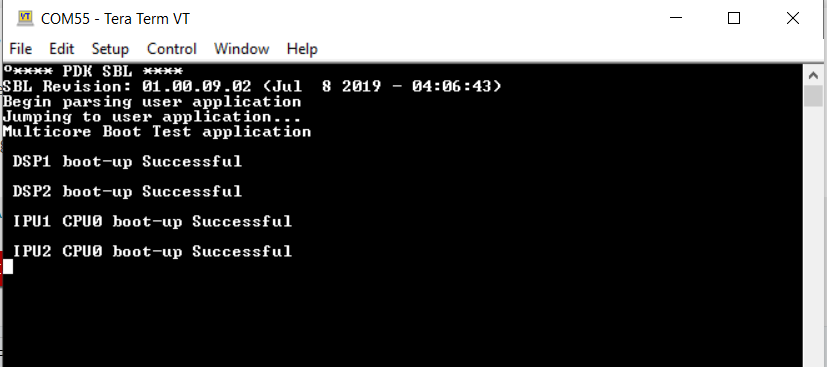

Copy the MLO and application app in the SD card,Board power on,The terminal prints the information as follows:
**** PDK SBL ****
SBL Revision: 01.00.09.02 (Aug 3 2019 - 00:16:46)
Begin parsing user application
Jumping to user application...
Multicore Boot Test application
No print message for “DSP1 boot-up Successful“ 、“IPU1 CPU0 boot-up Successful”.Is the code of the dsp and ipu core not loaded when compiling the app?
How to solve this problem?

  • Did you execute the make example option in addition to build the SBL as described in the article here:
    http://software-dl.ti.com/processor-sdk-rtos/esd/docs/latest/rtos/index_Foundational_Components.html#linux-environment
    The fact that you have exported the path to the binary but the script doesn`t find the binaries indicates to me that the binaries may not have been built.  Can you browse to the path and indicate if the DSP and IPU binaries have been built ? From the log it appears that only A15 application binary has been built in your environment so the resulting app only contains ARM binary.
    At my end, I was able to build the binaries using the following command :
    cd pdk_am57xx_1_0_13\packages\ti\boot\sbl
    gmake example BOARD=evmAM572x SOC=AM572x BOOTMODE=mmcsd
    Rahul
    I tested the Windows case and I didn't get this working. I opened a ticket to track this.
    Regards, Eric
    I thought I need to update the test setup:
    1) build with "gmake example BOARD=evmAM572x SOC=AM572x"
    2) Setup the env:
    set TI_PDK_INSTALL_DIR=c:\ti\pdk_am57xx_1_0_15
    set BIN_PATH=%TI_PDK_INSTALL_DIR%\packages\ti\boot\sbl\binary
    set TOOLS_PATH=%TI_PDK_INSTALL_DIR%\packages\ti\boot\sbl\tools
    set PDK_INSTALL_PATH=%TI_PDK_INSTALL_DIR%\packages
    set App_MPU_CPU0=%TI_PDK_INSTALL_DIR%\packages\ti\boot\sbl\binary\evmAM572x\example\a15\mpuc0\bin\sbl_app.out
    set App_MPU_CPU1=%TI_PDK_INSTALL_DIR%\packages\ti\boot\sbl\binary\evmAM572x\example\a15\mpuc1\bin\sbl_app.out
    set App_DSP1=%TI_PDK_INSTALL_DIR%\packages\ti\boot\sbl\binary\evmAM572x\example\c66\dsp1\bin\sbl_app.xe66
    set App_DSP2=%TI_PDK_INSTALL_DIR%\packages\ti\boot\sbl\binary\evmAM572x\example\c66\dsp2\bin\sbl_app.xe66
    set App_IPU1_CPU0=%TI_PDK_INSTALL_DIR%\packages\ti\boot\sbl\binary\evmAM572x\example\m4\ipu1\bin\sbl_app.xem4
    set App_IPU2_CPU0=%TI_PDK_INSTALL_DIR%\packages\ti\boot\sbl\binary\evmAM572x\example\m4\ipu2\bin\sbl_app.xem4
    3) Run script: c:\ti\pdk_am57xx_1_0_15\packages\ti\boot\sbl>tools\scripts\AM57xImageGen.bat

    4) Copy app and pdk_am57xx_1_0_15\packages\ti\boot\sbl\binary\evmAM572x\mmcsd\bin\MLO into a MMCSD card
    5) Power on
    UART output:
    Regards, Eric
