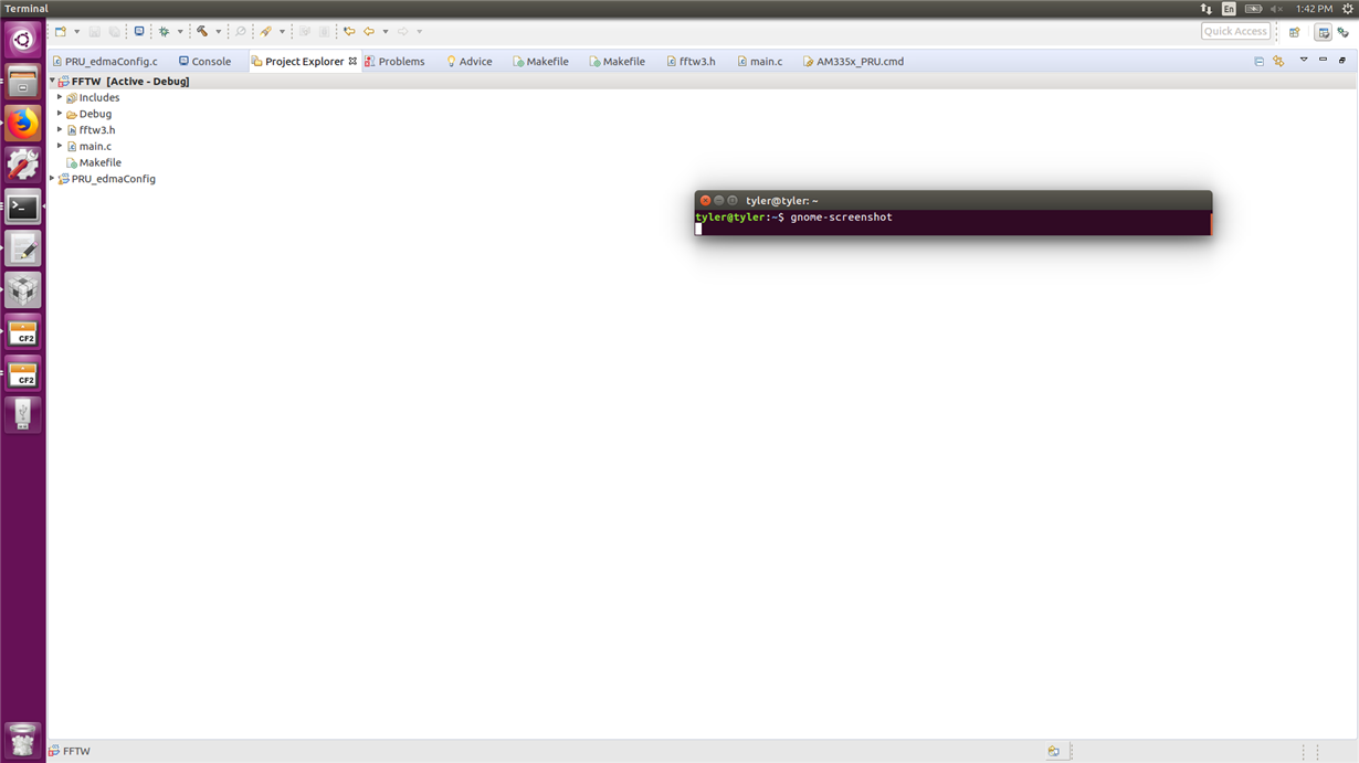

I am currently trying to figure out how to integrate FFTW into CCS. I am using the ti-processor-sdk-linux-am335x-evm-06.00.00.07. I am trying to incorporate the SDK examples with FFTW.
This is the error I am getting:
I made sure to include the fftw3.h in my project.

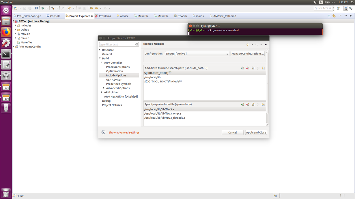

Here are my include files:
All I have in my code is the header file:
Is there any suggestions anyone can provide? I can compile/run the FFT code I wrote using FFTW, but for some reason I can't run the code on CCS. An example command I use to compile the FFTW code in a terminal is:
gcc fftw_example.c -Wall -lfftw3 -lm -o fftw.example
Do I need to add the -Wall, -lfftw3, -lm, and -o commands to a makefile in CCS?

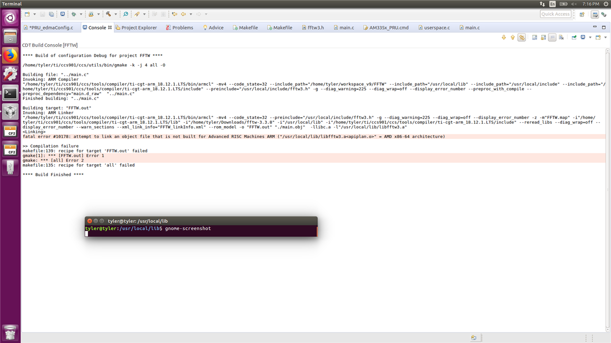

    I am trying to compile FFTW code on CCS. However, when I try to build the project, I get the following build error below due to a linking issue:
    I believe I have FFTW installed correctly because I am able to compile my FFTW code using the following command in the terminal:
    I am currently using ti-processor-sdk-linux-am335x-evm-06.00.00.07 with Ubuntu 16.04.
    Any suggestions are greatly appreciated.
    Tyler
  • Tyler,
    Have you made any changes to GCC to tell it to cross-compiler for ARM? if not, I believe you are successfully building FFTW for you x86 Linux machine. CCS is setup to build for the ARM, but it doesn't have access to everything it needs to build all code for the ARM.
    The instructions that you pointed to seem to be using a native compile on the ARM by moving everything to the ARM target board and building it there. This will probably be the easiest approach by far unless you are very familiar with how to set up cross-compile environments.
    Since FFTW is an open-source component and not really integrated into the SDK, we don't really support it. You might find better support from them if they support cross-compiling.
