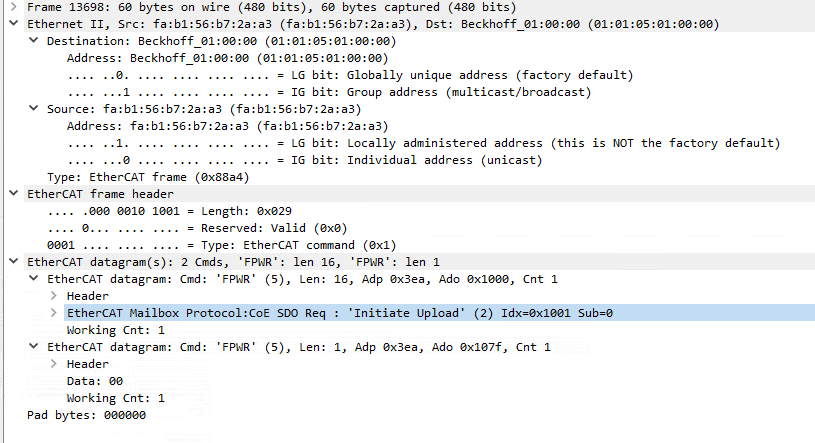

    Again, here the address in WireShark:
    EtherCAT Mailbox Protocol:CoE SDO Req : 'Initiate Upload' (2) Idx=0x1001 Sub=0
    Header
    Length: 10
    Address: 0x03e9
    I can confirm that the PRU use in some way or another the address of "itself" because I modify my slave address and the result on the wire change accordingly.
    The end result is, I cannot reach the targeted slave!

  • Hi Stephane,
    Is it the fixed offset '1' (0x03ea- 0x03e9) between the written address and captured on the wireshark?
    Can you please show a connection topology of your setup including master and slaves? How can this be reproduced in my side?
    Garrett
  • Hi Garrett,
    The offset is 1 only because the two slaves are "side by side" with address automatically assigned by the master.
    The simplest configuration that can reproduce the bug is:
    Master (TC3 win x86) -> Sitara with full slave EtherCat demo (Addr: 0x03e9) -> OtherSlave / Elmo drive (Addr: 0x03ea)
    On the sitara I execute the code to do an  SDO upload request:

    You will see:
    1 - No reply / print about COESERVICE_SDORESPONSE
    2- In Wireshark that the address of 0x3ea is replaced by 0x3e9 (the sitara address)
    The bug only append with expedited upload (<= 4 bytes payload reply) but not all.
    Example, Index 0x1000 work well (In fact, is is the only one that I saw work).
    Stéphane Germain

  • Stéphane,
    I don't have an Elmo Drive, so used an AM335x ICEv2 with full EtherCAT stack as the 2nd slave.
    Garrett
  • Hi Garrett,
    Sorry for the delay, the issue is more complicated than expected.
    So as often in complicated issue, it was in fact 2 bugs.
    1) Elmo is sometimes not responding to Slave to Slave SDO and this have been reproduced by other stakeholders.
    2) The "address" issue observed with Wireshake (only with TwinCat 3 master, not Acontis master) is still true.
    The spec is clear, the mailbox header address field should contain the address of the requested device: “Station Address of the source, if a master is client, Station Address of the destination, if a slave is a client” EtherCat group support cannot reproduce this part of the issue!
    So I would like to know if your test have reproduce it?
    Thank you,
    Stéphane Germain
  • Hi Stéphane,
    I used the ecat.adp=0x3ea filter in wireshark and can see it in my capture from netAnalyzer.
    Garrett
