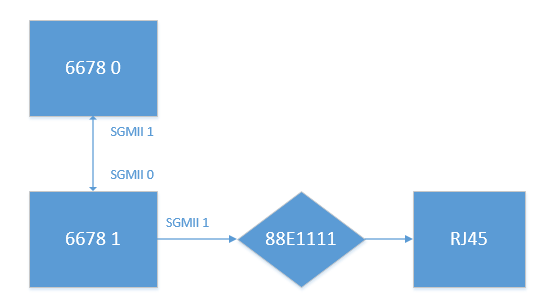

Hello Champs,
Do we have 3-port Gbe switch example for reference?
Customer wanted to know how to configure send data from DSP1 SGMII1 to DSP1 SGMII0 or vice versa.
Thanks.
Rgds
Shine

  • Hi Yordan,
    Thanks for your reply.
    Customer wanted to realize PHY->DSP1 SGMII1->DSP1 SGMII0->DSP0 SGMII0->DSP0 SGMII1->PC. It is similar like below post.

  • Shine,
    This is not the way typically a switch operate. By default, the Ethernet switch exchanges any packets among 3 ports (SGMII 0/1 and host). However, the SGMII 0 and SGMII 1 have different MAC address, the switch has ALE, once it received packets from either port, it will record the source address and later only sends the packets to the designated port.
    It would be easier for you to let host receives the packets from SGMII 0 and SGMII 1 (not using switch to forward between two SGMII ports), then host software implement such packets sending (received from SGMII 0 to SGMII 1, and vice versa).
    Regards, Eric
