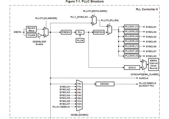

    In the debugger, I'm able to turn on the observation clock OBSCLK and set the OSCDIV to a reasonable value so my 60 MHz oscilloscope can see the signal (programming the it to 19 sets it to 20 which is a good round number) and the output is 24 MHz which means the processor is indeed running at 480 MHz. At this point changing any of the PLL pre dividers, post dividers has no effect. The OSCSEL seems to work with the exception that when set to 0x14 this should be the 24 MHz oscillator. But with this (taking into account theOSCDIV is set to 31) the output is still 480 MHz. Setting it to the other SYSCLKs all makes sense with respect to their default dividers. But again changing those divisors has no effect. I'm thinking that maybe once the PLL is turned on these registers are locked out. The other thing that doesn't make sense is that the PLLCTL shows that the PLL is powered down, reset, and in bypass mode. This doesn't agree with the frequency I'm seeing at the output.
    With nothing in the data sheets to explain this behavior I'm starting to believe that this is a problem with the newer silicon. Is anybody else using the d800k006 silicon? Does anyone have anything I can try?
    I tried the same tests on the evaluation board (Zoom am1808) and they behave as expected. This proves that my debugger is not doing some register manipulation before I'm able to observe it.
  • When you set OSCSEL to 0x14, the output of OBSCLK is equal to the crystal.  It does not show the actual operational speed of the device.  Below is a snapshot (taken from the system reference guide) of how the clocks are connected.  To know how fast the UART is operating at, it will be best to monitor SYSCLK2 since it feeds into the module clock.

  • Did you set the Enable bit in the OSCDIV register?  Can you provide a dump of the PLLC0 register contents?  What is the clock input frequency?
