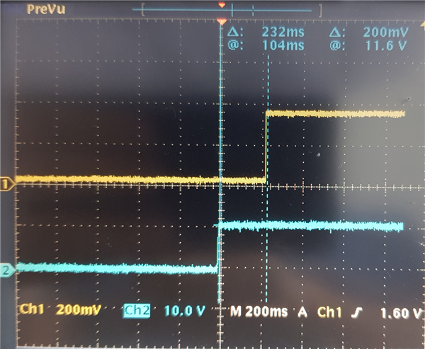

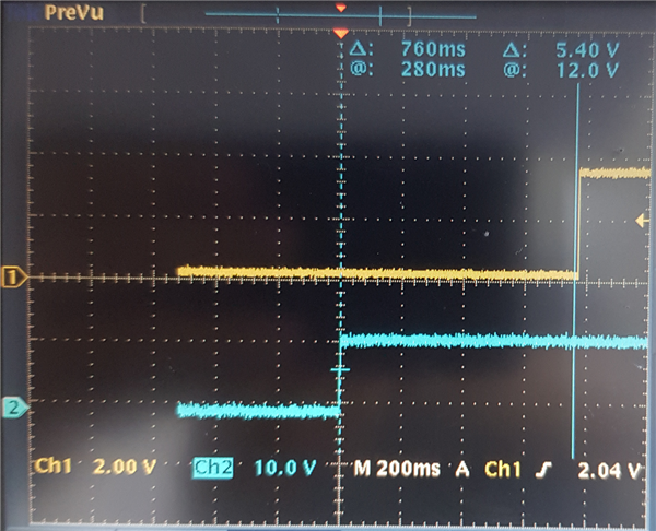

  • There is the Power up sequence timing difference between normal system and fail system.
    < figure 1 : normal system , CH2 : 12V power PCIE edge, CH1 : PERST# >
    < figure 2 : Fail system , CH2 : 12V power PCIE edge, CH1 : PERST# >
     The problem and solution list is
    1) PERST# connected to PORn of SOC ==> Cut PERST# and connect to user input to monitoring.
    2) PERST# activated time is too short to boot up SOC. ==> Request to BIOS vendor that change the PERST# active time to mininum 800mSec.
    3) Minimize the boot-up time(code optimize and so on)
    In my case, If the BIOS vendor reject the request, the project could be drop.
    So I think that People who want to use PCIeSS on TI-DSP to connect with various PC system have to consider this issue.
