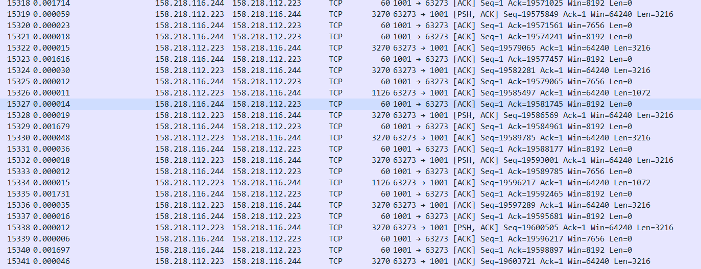

TMS320C6655: C6655 with NDK package too big send interval
Part Number: TMS320C6655
Dears
  We is used in application TMS320C6655 network interface, when use TI provides the NDK package, encounter problems, needs in interval between two send package more than 3-4 ms to normal to send, interval with sleep function implementation, if the interval is lower than 3 ms software program will run to fly, freezes, operation is not normal, but the interval for application is too big, need around 100-200 us, please help to analysis what is the cause of this?Or does the NDK software routine need to be applied in this way?Thank you very much!
